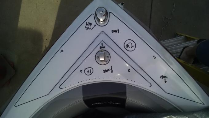

    Got my template, about to start drawing/tracing on the mylar, wondering if anyone has any helpful tips before I start (or before sending it in) that they would have liked to know before starting the process? Watched the YouTube tutoirals, but if any of you have suggestions on things like corners, or clearance, distance from cleats, etc, I'd love to hear them. Thanks

      This is what I did and glad I did it this way. You should be able to get a “dry fit” template from SC Wake. They probably have a file for your boat anyway. If so, use that as a starting point and mark up slight changes for your boat vs. starting from scratch. If you’re already set to start from scratch anyway.... use lots of tape, pre-trim edges to get Mylar to lay flat, do some overlap of the non-slip fiberglass if you have that texture on your floor, and I personally like the look of getting the lines close to things like cleats, latches, screw holes vs leaving lots of white fiberglass showing. Hope that helps some!

        Thank you both for your advice. My boat already had seadek, I'm just adding some additional on the bow and sides.
        And yeah, strangely enough seadek said they didn't have template for my boat ( which I think is bogus... As I've seen it on my exact boat- year, make, model, etc)... But maybe because the cleats and tower mounts seem to be hand placed, as my port vs starboard side sides are not reversed copies of one another.

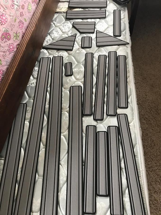

                  please post how things go.......I had a really hard time with Sea Dek....and ended up using Aqua Marine Deck. Same exact product....I got all custom cuts done.....1.5 week turn around......$500.......18 customer pieces......and email response within 1 hr. .......just thought I would throw the option out there for people.

                      No stock....but I used the Sea Dek platform package from Naut Parts.....got all my other pieces around the hull top custom cut by Aqua Marine......and the grey teak matches sea dek's perfectly.

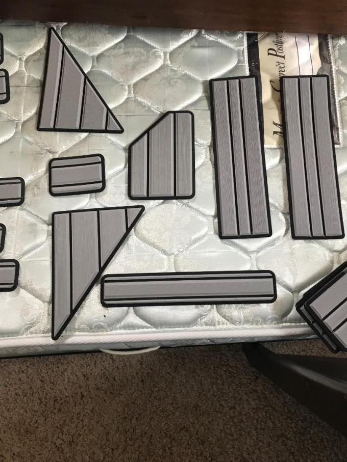

                        4 " Rectangles are Sea Dek........everything else is Aqua Marine........As you can see.....very close. All pieces except rectangles......Less that $350 plus ship
