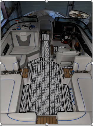

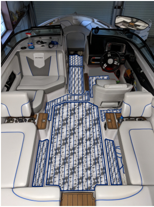

                        Thinking bout going with the snow camo ....what ya think?

                          • scottb7
                            • Aug 2011
                            • 2198
                            • Carson City, Nevada
                            since you asked...not a big fan of that pattern.
                            • GMLIII
                              • May 2013
                              • 2821
                              I’m not a fan of that pattern either but there again that is only my opinion
