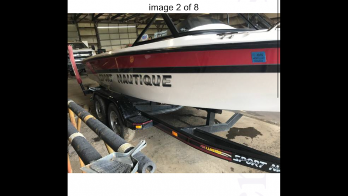

I'd also confirm the boat was actually a 1994. With pics we could help with that.

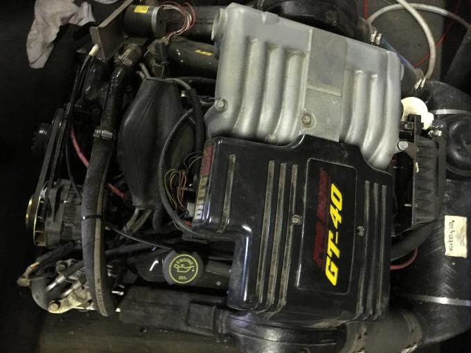

The title confirms the boat is a 1994. I am trying to attach pics of engine and what I have of the boat. Owner says his mechanic say told him its fuel injected. I have seen some threads regarding the pro-tech ignition failing and being expensive to repair/replace. Should I be concerned, the boat has just over 500 hrs.
You have the GT40 engine which means no pro tech. So that is good. From the pics I can see that's a GT40 with a Fuel control cell, so it's not an early GT40.
Also those graphics were not the typical 94' graphic. They could've been changed.

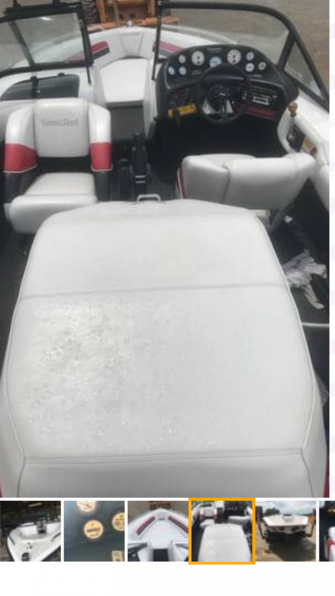

Do you have a picture of the engine box, do you see cup holders for the rear seat?
The cup holders were added in 96 and I suspect that's what you may have.
Boat could easily be a 94 with a new engine and new graphics.
I did see a post with two capitains chairs. Looks like the area in front of the passenger is just open. So there is storage but it may be difficult to get larger things in there with the seat in the way.
No cup holders, I am posting a pic. So, that is the engine and ignition set up I want, right. The vin from the title is C494. So March 1994 production. I am going to call Correct Craft tomorrow to see if they can tell me how it was built. Asking $10k for it, no tower or Bimini. But it looks taken care of. I think I will run a vin check on it. Thanka for your help!
Well that settles it. It is a 94 with an engine swap.
Yes, that's the engine you want. Pretty much the best ski boat engine from the era. It was the last of the Ford Engines made by PCM. The 351 is a great ski boat engine as it had plenty of torque and out performs engines with higher HP ratings. The engine is also known to be very reliable.
