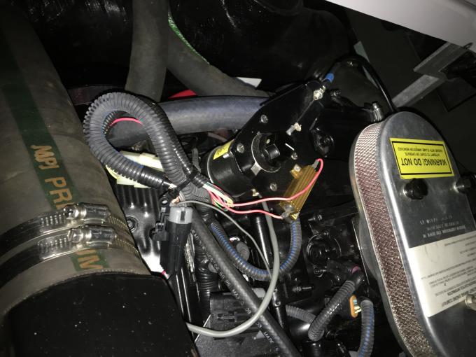

          Try this - assuming you have a PCM 330 (Mine is an '04). this is where I plug in the small diagnostic tool I have. It is a small electronic piece that blinks the LED light per the trouble code.

            homer12, can you share a picture of what tool you use, make or model of the tool? thanks much.

              That's where it was located on my 06 210 as well.
              On top of the engine
