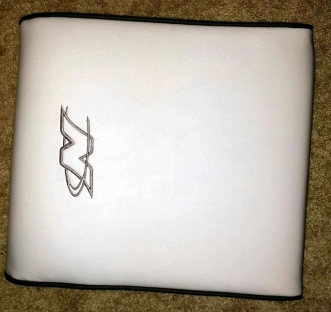

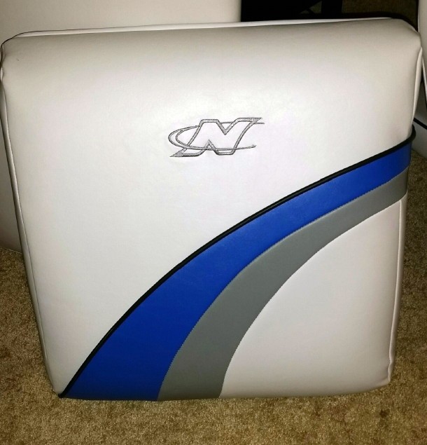

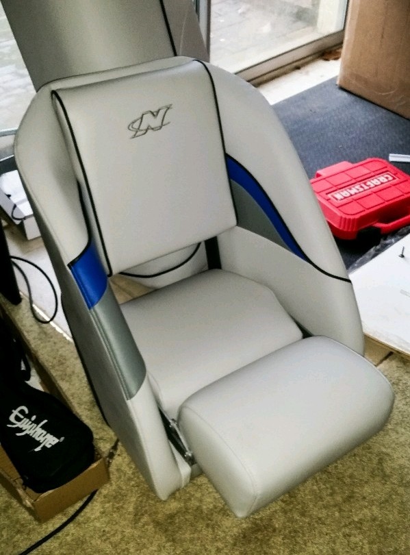

    I've been wanting to do this for years now, but finally took on this project this winter. I'm replacing all of the interior skins in my 2004 SANTE. They are now available from Correct Craft so I bought them through Nautiqueparts.com. Great customer service by the way. I'm about halfway done and so far everthing has been great quality. It hasn't been a bad job, just time consuming. Here are a few of the finished product. So far I'm very happy with the results.

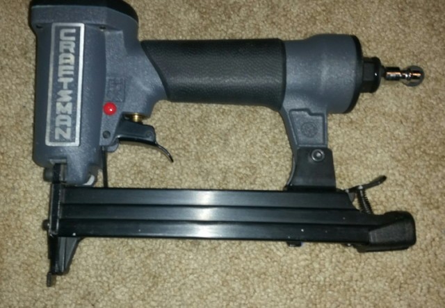

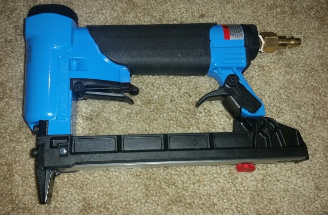

            I started off with my Craftsman stapler that I've had for many years. I originally bought Senco staples for it. The specs were all the same, but they didn't fit. Apparently the only staples that fit a craftsman stapler are Craftsman and Duofast. I found duofast style staples on Amazon branded Spot Nails

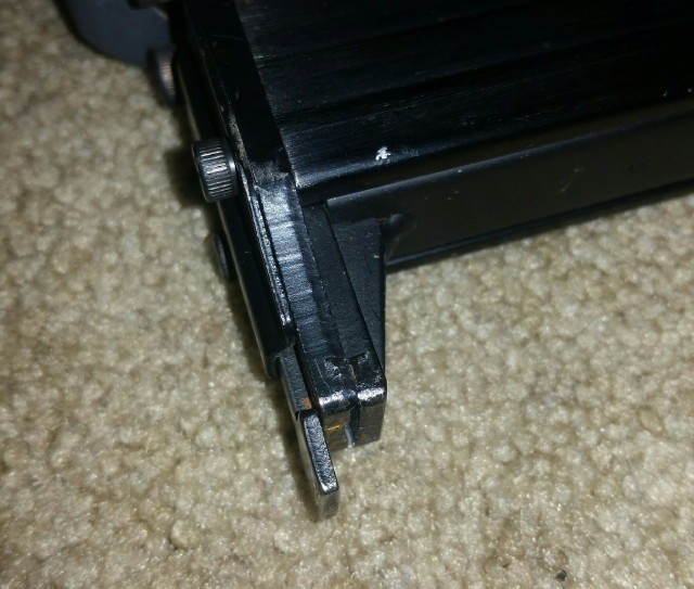

            It worked great until I tried to staple the hidem trim on the bottom of the seats. The tip on this stapler (because of the safety on the tip) will not fit inside the hidem trim. Here's an example of the hidem trim and the tip on the Craftsman stapler
            That "safety" actually allows you to use the sequential method (where you just hold the trigger and every time you tap the stapler a staple fires), so this staple gun is great to use for everything else.

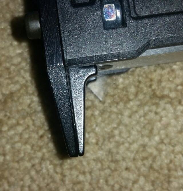

            On Amazon, I found this Fasco stapler for $115. It has the safety built into the trigger, so the head is much thinner and works with the hidem.
ID:	547527Click image for larger version
Name:	Fasco label.jpg
            It also uses the same Duofast staples that the Craftsman stapler uses. So I've been using the Craftsman for most of the project, and the Fasco when installing the hidem. Hope this helps!

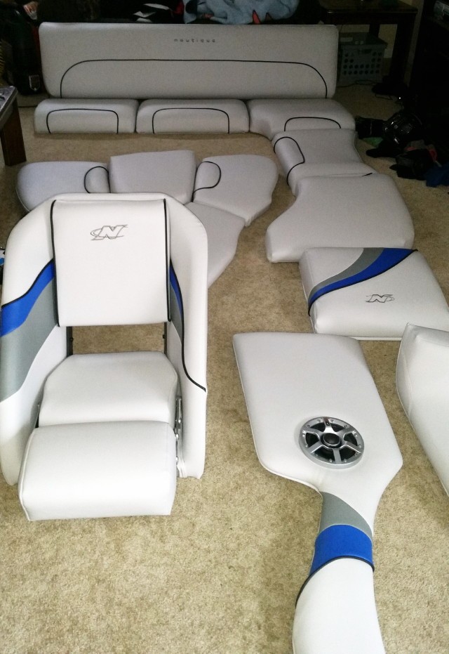

                Everything I brought home is done. I'll have to pick up the bow splash and hatch covers when I take these to the boat.
                  Click image for larger version  Name:	boat interior basement 2 resized.jpg Views:	1 Size:	129.0 KB ID:	547933
                  Congrats.
                  I've done this myself and while each piece vis satisfying, getting it all in the boat is amazing.
                  I sold my boat while is was doing the upolstery and basically got all the pieces fitted less then an hour before the boat was picked up.
