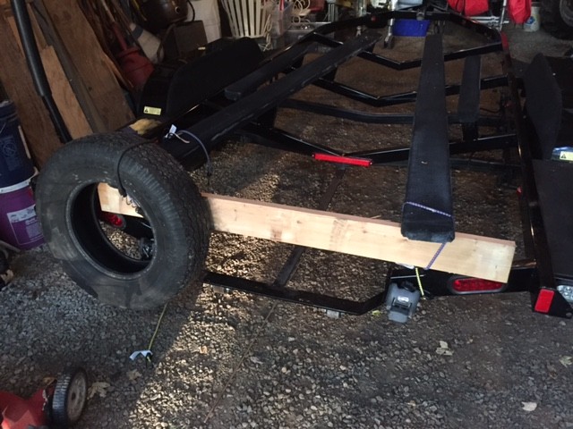

        I would seriously look into another trailer- something like a Boatmate or a Phoenix or a used Ramlin. There should be no "adjustments" when the trailer is made for the boat. Whatever they are selling sounds like fits all fits none.
        Sorry for the not so detailed photos,but these are of my '14 Phoenix built for for my '95. I don't care for the roller on the front,it creates difficulties loading and unloading on steep ramps. This summer I'm going to cut it off and replace with a bow stop which the boat noses into
