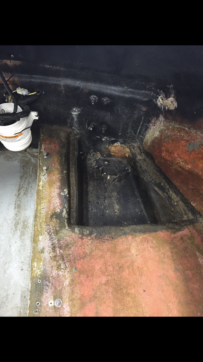

    Does anyone have any pictures as to what the compartment set up for the blower, pumps, ballast piping etc......looks like finished in the rear compartments? Mine has all been trashed and am re-doing it now. I cannot for the life of me find pics of what the original set up should look like. Thanks D

    I have an 02, but can't imagine they are much different. My blower is attached to the transom, behind and below the muffler. There is a short piece of that corrugated black tubing that connects the blower to the vent that comes out just below the engine cover at the center of the transom. Its a real pain to get in there to replace a blower when it goes out. I can't tell exactly what is going on in you pic. Is that the fresh air intake hose for the engine compartment? I am pretty sure mine is all sub floor and starts under the helm.
    The ballast is a little more complicated depending on what you are trying to do and if the boat had ballast before. There have to be about 100 ballast write ups out there though.

      hey there.....thanks....I will try to take a few more pics......but your comments are leading me in the right direction. In the pic....i have trashed flex tubing on the left side of the pic that connects to a firm piece of piping and then is connected to flex pipe again....and cut off behind bench seat. Sounds like your blower is placed on the left side of my pic and the tubing is continued to the top of the engine cover. Thanks for your help......hoepfully someone else can chip in and provide some more details.
      FYI pulled stock tanks and put 2 750# sacks instead. .....like you said...tons of threads on this

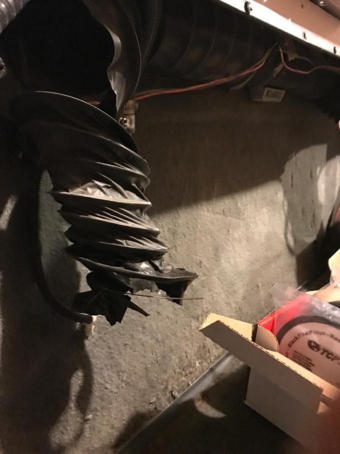

        I found this picture.....looks like the flex blower tubing goes from the engine area? around the side to the back of the bench? Where does the blower get attached? Anyone...anyone?

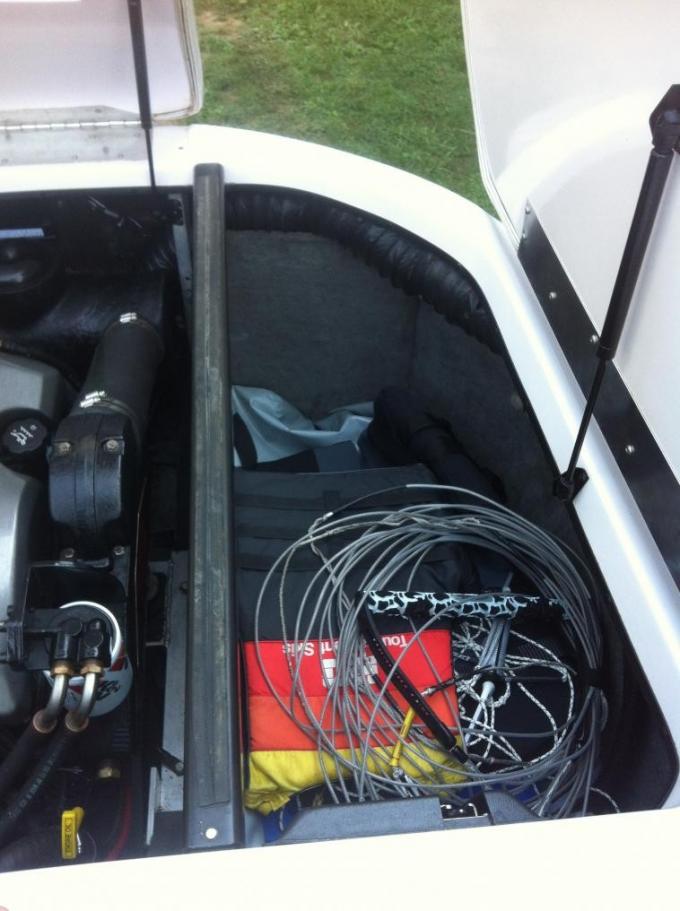

          this is where mine attached.

            T....thank you very much!
