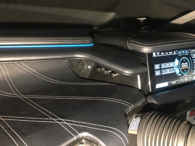

      I put a separate tower and interior volume control knob and could not be happier. I think the fiddling through screens to control volume got better with 2018, but it cannot be more simple than my rotary knob.
          I did exacting what Tallredrider did , I had the stereo elite version in which I was not able to control the tower speakers separate from the cabin speakers; this scenerio was terrible. As a result, I put in 2 manual zone control knobs to separate the tower from the cabin speakers. Although I only have 2 zone control knobs, here is Kporsch's G23 with 3 manual aftermarket zone control knobs. I love my new set-up , very easy to use vs going through a bunch of screen prompts on the Linc screen while driving.
