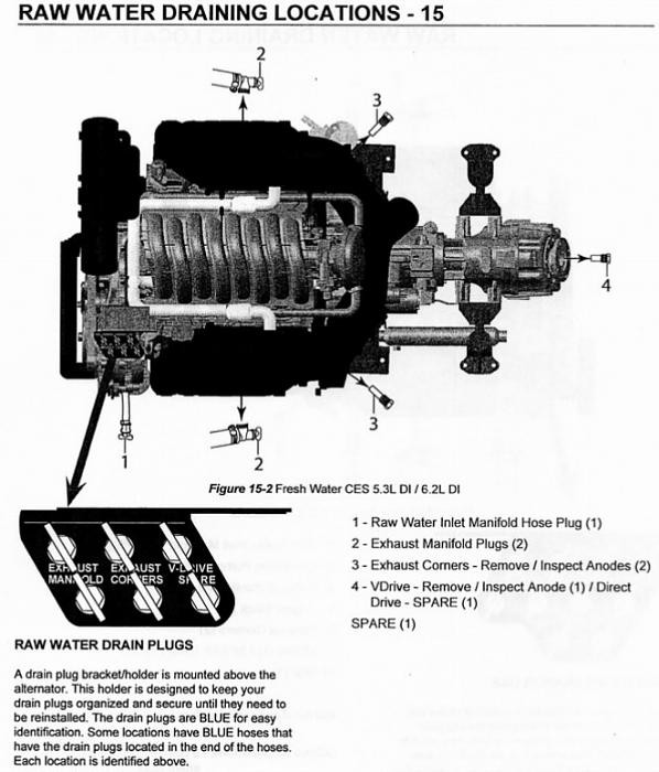

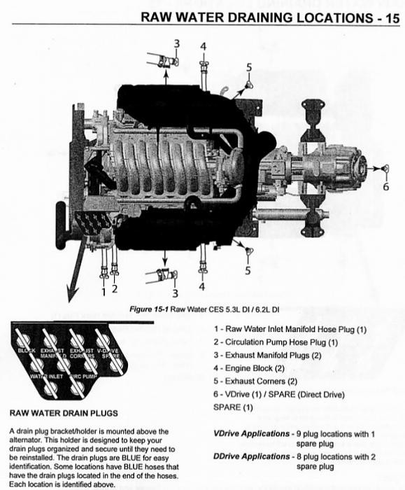

I have a new to me 2017 SAN 230 with the H5 Coastal closed cooling. I have been looking for the Number 1 Location Raw Water Inlet manifold hose plug. I see it on the above diagram that Jeff posted. When I look at the cooling System parts list for the H5 H6 coastal addition it is not a part that is shown or any part numbers, page number 24 or 26.
It is however shown on page 22 open loop cooling diagram and it has a part number.
Is this number 1 manifold plug not on the coastal closed edition engine? Just making sure that I get all the water out in Northern IL
