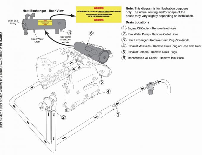

GMLIII I am not sure about drain locations....but did read that the H5 and H6 heaters are raw water cooled and have to be drained and blown out. You probably know this, just figured I would throw it out there since ZR409 & ZR450 are closed like Jeff mentioned.

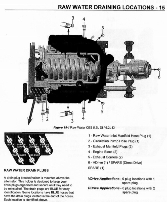

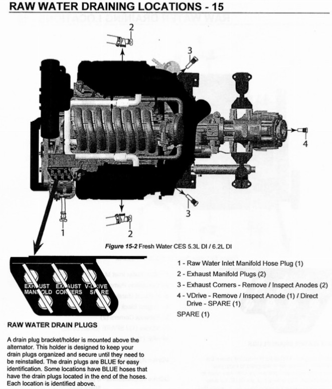

On the H5/H6, they will all have the blue plugs and are super easy to drain. Takes all of five minutes. The only thing that doesn't have a plug is the heater, and that just requires disconnecting the two red hoses and introducing air pressure into either one to force the water out of the other.
Here are the drain locations for the H5 and H6 (NON-Coastal):
Here are the drain locations for the H5 and H6 (Coastal):
Infinity since I have a Coastal Edition my heater is a closed system therefore I do not need to drain. Jeff thanks for clarifying Coastal vs Non Coastal drain locations. PCM manual does not make that difference very clear
You're right, they don't. And yes, I would assume with the closed-cooled H6, your heater should be included in the closed system with no need to drain.Please do not PM me directly asking for advice on how to repair your boat. While I would love to help everyone, I simply do not have time to respond to all of the inquiries. Please post your questions on the forum, so that all of our members have a chance to answer.
