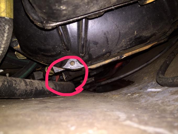

                            Charles, if you have a drain hose, why would you use the other system? Does this Click image for larger version  Name:	IMG_0765.JPG Views:	1 Size:	47.2 KB ID:	542406
                            look like where it should have been?

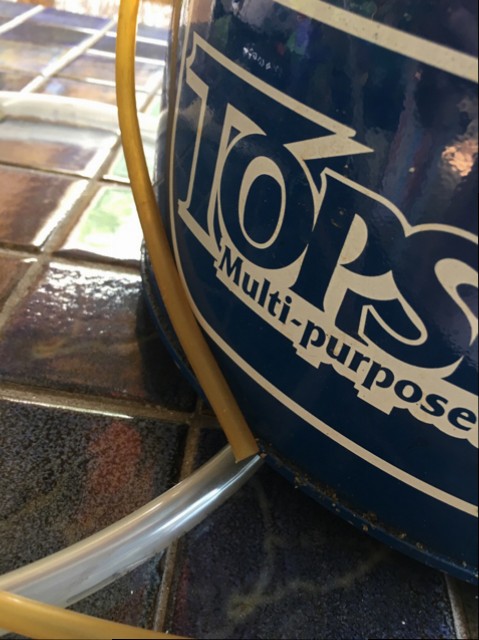

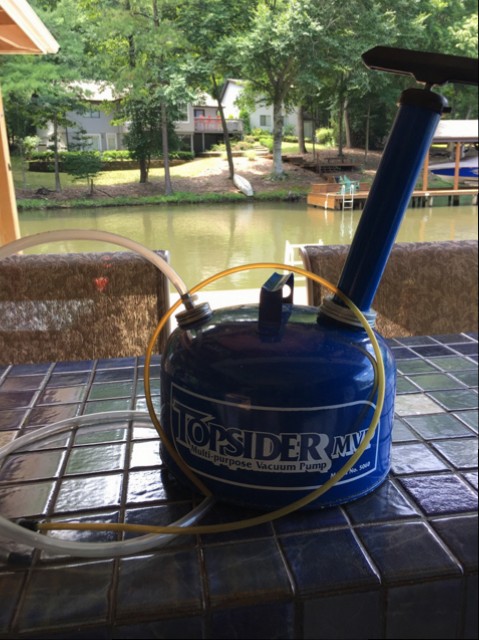

                              I'm not sure what you mean by "the other system." My boat is on a lift. I don't even own a trailer. There's no practical way to get under the boat and drain the oil out through the bottom. So I use an oil extractor. There are lots of them on Amazon, Overtons, etc. Actually, even if I had a trailer I'd still use the extractor. It's easier and less messy.

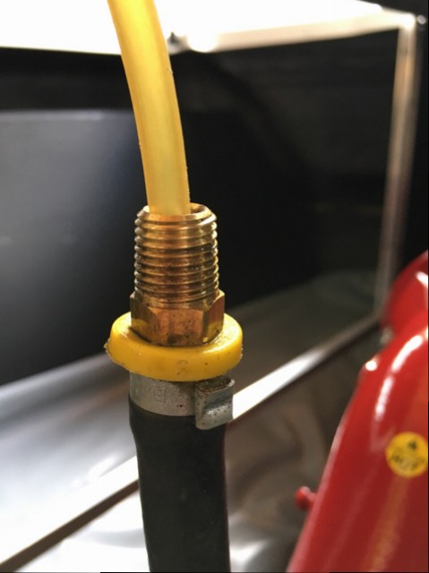

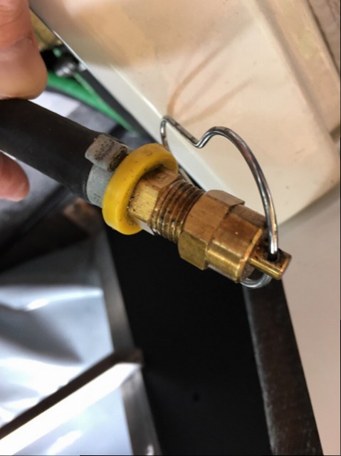

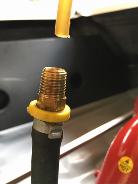

                              Anyway, it's hard to tell from the photo but that does look like the oil pan plug you have circled there. There should be a brass fitting there with a barb end going to a length of rubber hose. The hose would then have a brass plug screwed onto the end of it.
                              When I change the oil, I simply remove the brass plug and thread the "snout" of the oil extractor in. It draws the oil out into a can and I later empty it at Jiffy Lube.
                              -Charles
                              Click image for larger version  Name:	11dbbe5f56120001eca7d89bec3ea254.jpg Views:	1 Size:	92.1 KB ID:	542421
