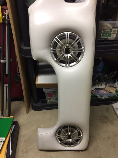

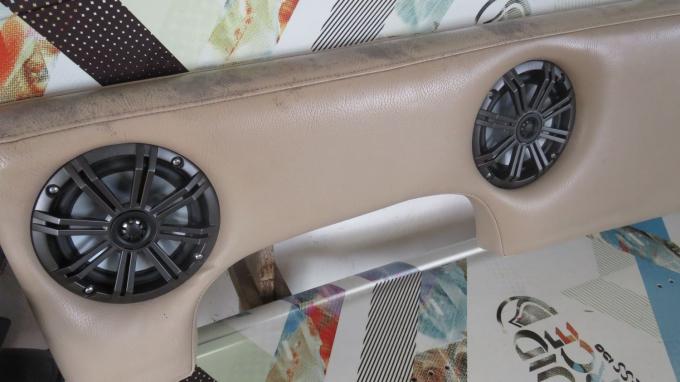

      No there are no PVC rings. I don't have any piping so would have to have some made. Never going to match the color of the skins so maybe I should install them without the cloth, but flushed like here:
Name:	Speakers coaming pad.2.jpg
      Would rather have them out of sight though...

          If you want to maintain the flush look, I think your best bet is to make piping out of black vinyl and then replace the cloth over the speakers with black speaker cloth. If you don't want black, then NAWTEAK is a great suggestion.
          In my experience, speaker cloth always fades and looks worse over time, so I think the best bet is to just set speakers on top of the vinyl like you posted in #3. It might look hideous when shown isolated in your photo, but the fact is people do this all the time when replacing the stock speakers with Wetsounds, etc,....and, at least in 2008, Nautique mounted the speakers that way from the factory.
          Once installed, you'll never notice them again. Well, I wouldn't.

                  If I'd want them installed like this
                  would I just screw the speaker into the board of the coaming pad? What or where does the upholstery attach to?

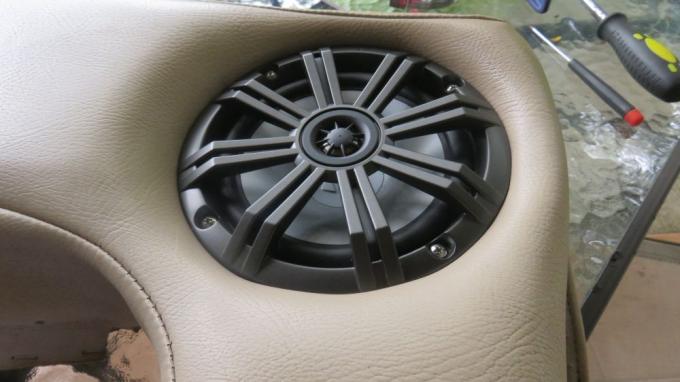

                    Originally posted by NAWTEAK View Post
                    Are the PVC rings still there? If so the speaker mesh is glued to that with the piping stapled to it as well. Then u cut a hole the vinyl and screw it to the plastic backing, 2 screws i can see the holes are still there. If the PVC is gone just buy some 6" tube with at least 1/4 wall for the screws.
                    And install speakers like you did here, you mean? What material is that ring, in between speaker and boat?
                    Click image for larger version  Name:	Speaker Nawteak.jpg Views:	1 Size:	24.3 KB ID:	543324

                      Here is my post on doing the same thing.
                      https://www.planetnautique.com/vb5/f...sport-nautique
                      I did some speakers from the front, and others I left the grills.

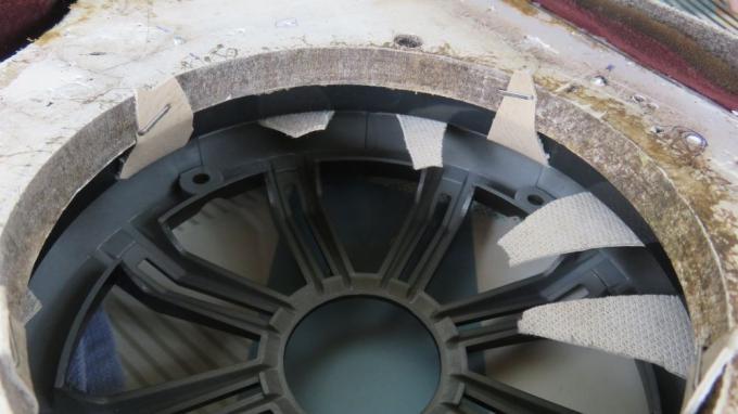

                      I used the black PVC rings (which i got off Amazon), that you can see in some of the pics. The ring is under the vinyl and the vinyl is between the ring and the speaker, stapled to the back board. Let me know if this isn't clear or if you have questions.
                      For the front mounted speakers (which I didn't document) I didn't mount the speaker inside the ring for a flush mount, I mounted on top.

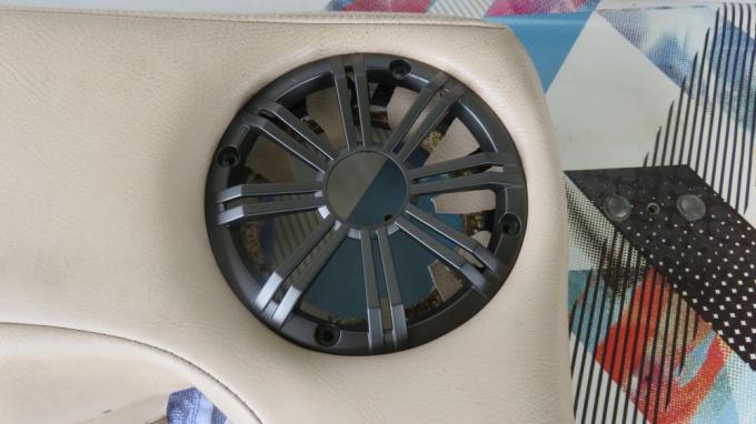

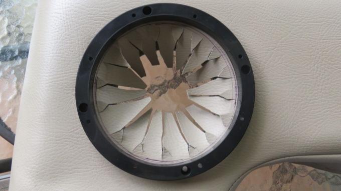

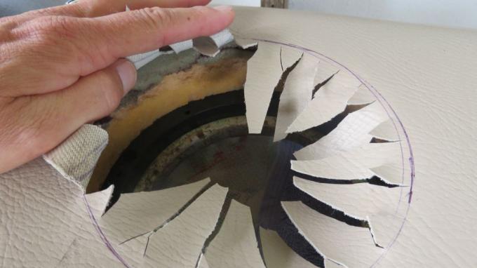

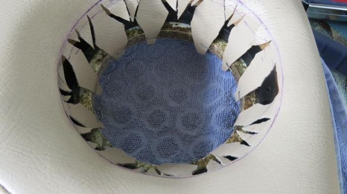

                        Can't friggin' believe but I DID IT! Only took me 11 months, no more!
                        Adding some pictures here for those like me that need it explained like they're 5
                        And thanks tons Blamey and NAWTEAK for your messages, they helped me a lot!
