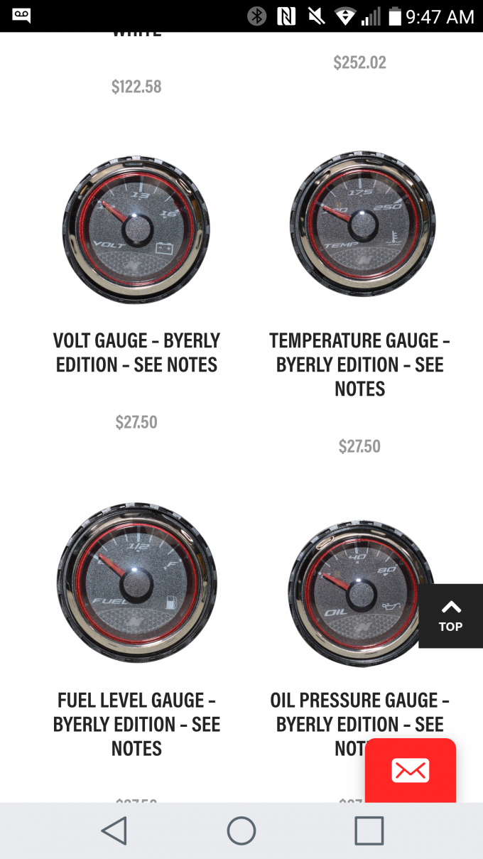

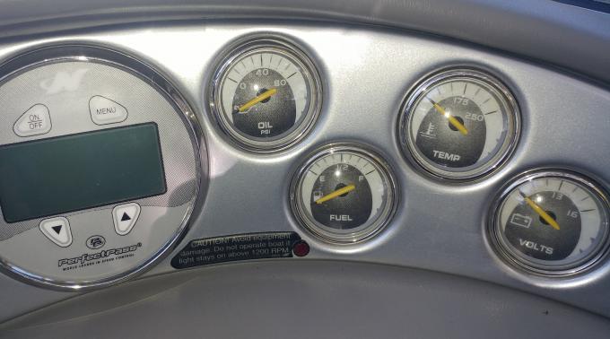

    I just purchased this boat in Sept. It's my first boat. The 3 daisy chained gauges don't work. (Oil pres, engine temp, fuel) I can get the oil pressure and engine temp from one of the bigger main gauges, so i don't think it's the gateway box. I'm assuming one of the gauges is dragging the whole serial communication bus down. The original oil gauge isn't available anymore and i need to use a 2007 style gauge, so I'll have different gauges anyway.
    Will these byerly guages work? They look like they use the same connector from the limited pic I've seen. Anyone know if these work? Click image for larger version

      What was the fix did you end up
      replacing the gateway box or just the gauges ?
      • Houseman
        • Oct 2017
        • 4
        • Ontario Canada
        • 2006 SV-211
        I replaced the 4 small gauges because they were only $28/each. And that fixed my problem.
