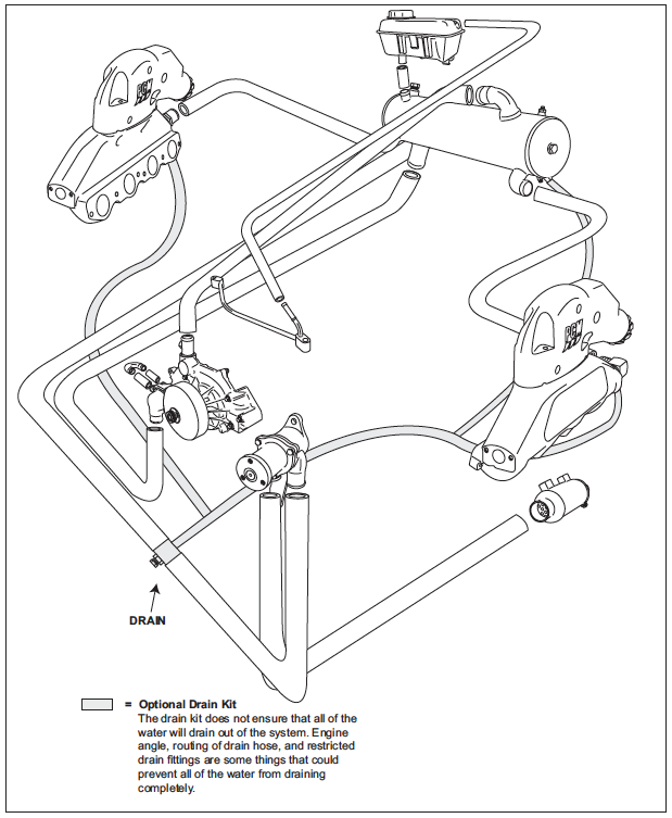

                          Scott, you realize there's a difference between a drain kit and a flush kit, correct? OP, check that all drain locations marked out in the manual are piped in to the drain kit (with appropriate sloping), and it should be alright. One thing you'll miss with a drain kit is the ability to poke a wire or the like into the drain ports to make sure they're clear.

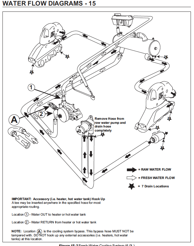

                              Late to the discussion, but it's also my first year with a ZR6 with the same closed cooling system and optional drain kit. Here are the water flow diagrams from the owner's manual so that we can all be on the same page with what's being discussed. The first image shows the closed cooling system and the seven plugs that need to be pulled to drain the raw water portion of the system. The fresh water portion of the system is anti-freeze so no worries there. The second image shows the optional drain kit referenced by the OP. The plugs have simply been replaced with hoses that lead to the front of the engine. In theory, pulling that one plug allows the entire raw water system to drain. I did a simple test of the drain kit over the weekend. I drained the raw water flow using the kit and then double checked at the seven plug locations to see if any additional water came out, and it does appear to be effective with one exception which is the plug marked "7" in the first diagram below. So in theory, to completely clear the raw water system, you would need to pull the drain kit plug and plug number 7. A crank or two on the engine to clear the impeller of water wouldn't be a bad move either. Is my theory sound? Any thoughts?
