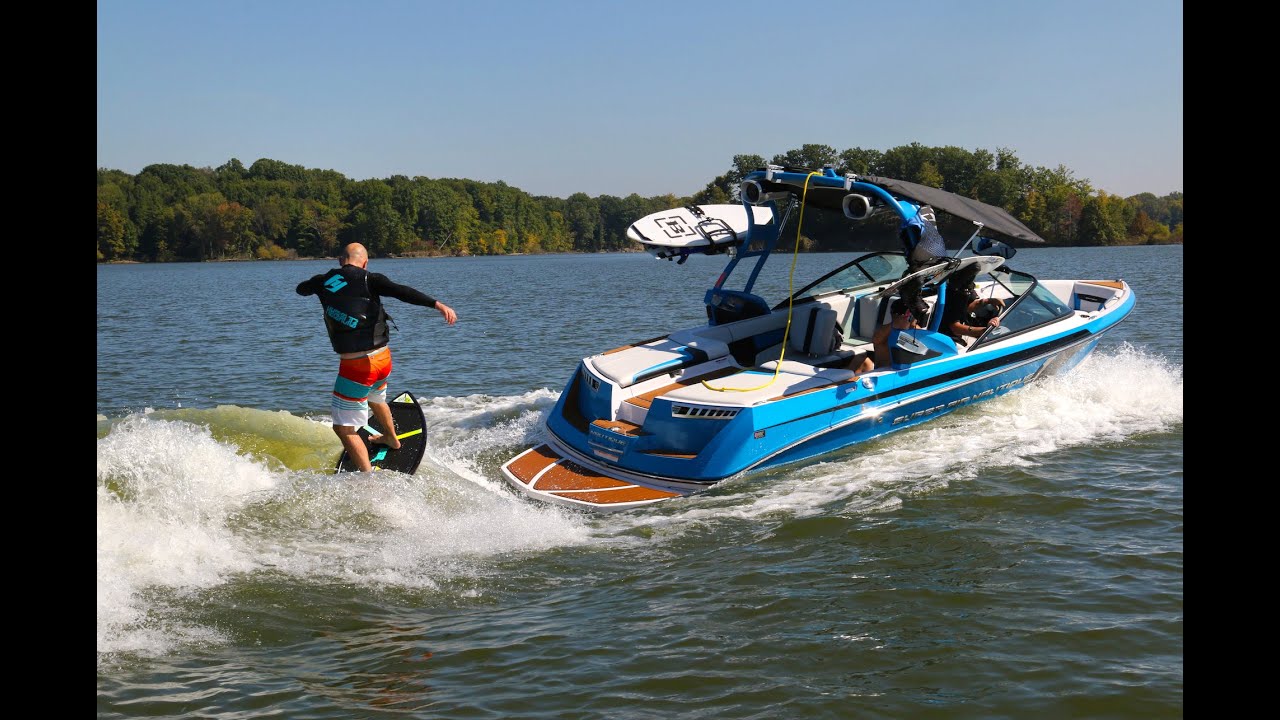

    Then this video says 5 is most aggressive, which seems to match the Nautique literature:

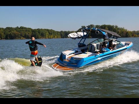

                        Here Adam does reference 5 being the steepest and 0 being the most mellow. He does however mention that the NSS will cause the transom to sink lower when deployed further toward 5.
