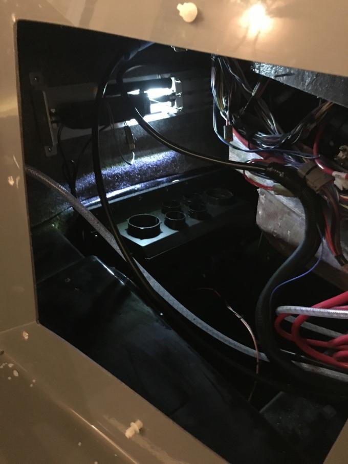

                        Technically, I did the 360 in my 17, but it is the same core as the 300.
                        i found a pic of where it is installed, in case you are interested.
                        i used starboard for a backer, and mounted to the inside hull (hull liner/stringer structure) with 3m 5200 (to dampen vibration transfer to the core), and screws. Then mounted the heater to the starboard.
                        not a great pic, but it gives you an idea. Mounting the core in this location had my swearing like a trucker, and crying like a girl, by the time I was done. Glad I did it though. This heater is incredible. I installed 2 hot tubes, defrost ports, one port blowing on my feet at the helm, and another blowing at my midsection at the helm.
