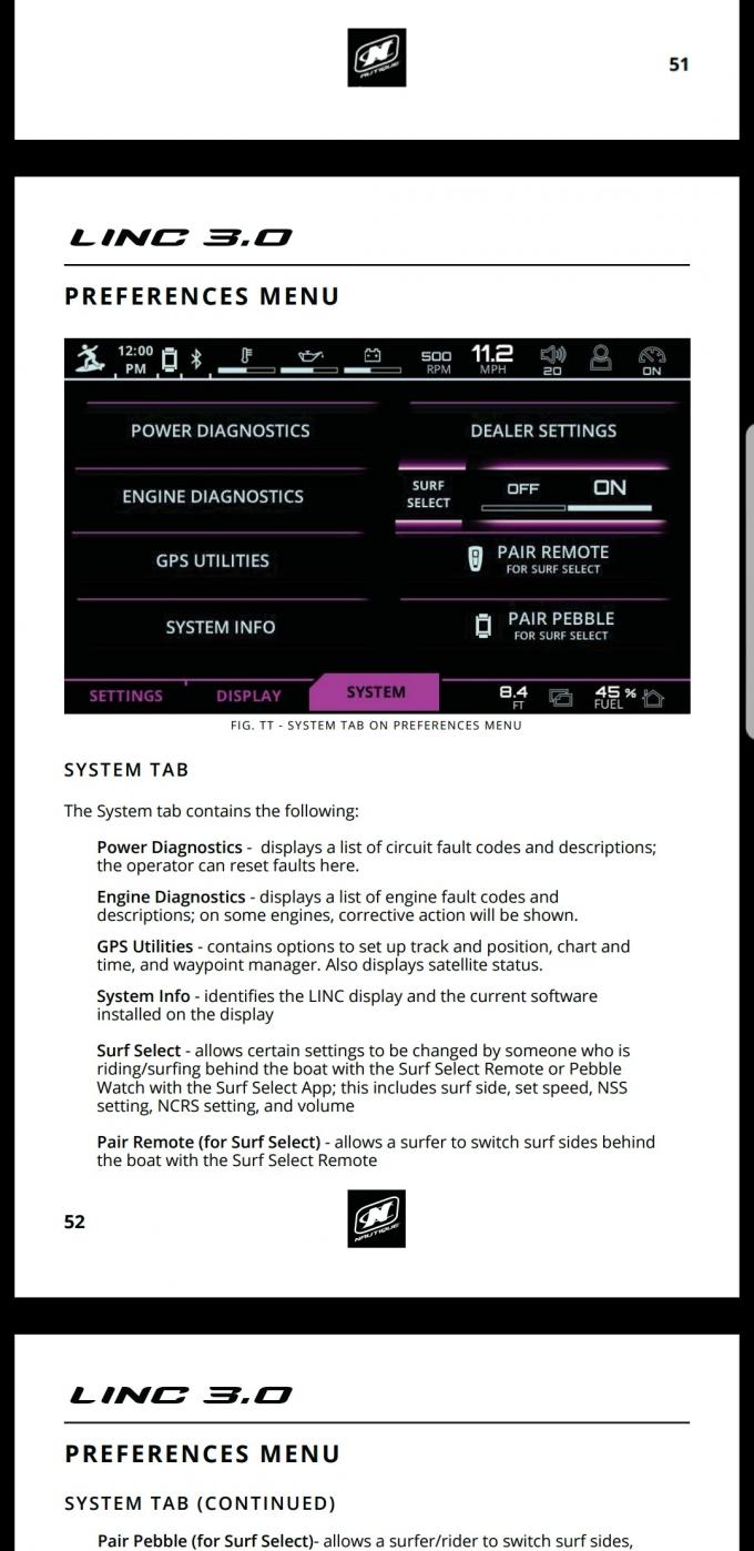

                  This is from the manual for the long 3.0 system

                    This is LINC 3.0 which I don't have so I may be wrong here, but I'm pretty sure that what you're looking at here is the System menu which allows you to turn Surf Select ON or OFF, if it's equipped on the boat. If you did not option this at purchase time, you will see no references on these screens for Surf Select at all. I also have a toggle for Surf Select under a different menu in LINC 2.0.
                    The only way to find out here is to contact a dealer and see if Surf Select can be purchased after-the-fact.
