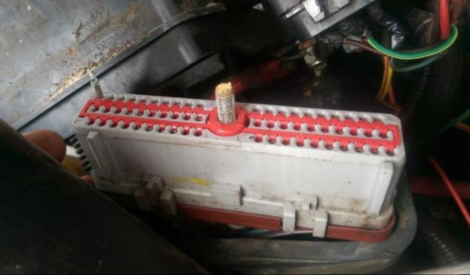

                      Well that joy didn't last long. One day, to be exact. Boat ran absolutely perfectly fine, started up each and every time without a glitch. Next time out the exact same issue occurred...
                      Found this today:
                      Ground pin came loose (top left).
                      GT-40 ECM experts: what do I do?! I'm trying to find that thread about reviving ECM's, but any help is welcome!
                      • TRIP
                        • 437
                        • Costa Rica
                        • 1997 Nautique Super Sport
                        Well since the last post I had the ecm fixed, the pin soldered back. Worked great again! For about 1.5 hour....
                        Then had the ecm checked by a lab where they confirmed it went bad. Luckily in the mean time had ordered an ecm off Ebay and bought the chip that I had shipped to t.franscioni who put the software on it and sent it off to CR (mil gracias amigo!). Already have the ecm, hoping to receive the chip in the next 2 days.
                        Hopefully back in business soon!

                              Today I put the chip in the ecm and plugged it in, and... fired right up again! I'm being a bit careful now as I thought I had it all solved 3 times before. But I'm pretty confident that this time it's for real.
                              Could only let it idle for a few minutes today, but will take it for a spin and probably some riding tomorrow.
                              Hopefully to NOT be continued!
