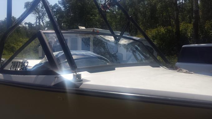

          Windshield replaced. Tempered glass cost $210 cdn. Glass shop did a great job making the template. Was 15 minutes of psyching ourselves up and figuring out the best way to do it. ~5 minutes installation time. Used a ton of dish soap to make frame and gaskets super slippery, 4 people (1 one either side and 2 in the boat), and voila! Slid in fairly easily and zero problems with the bow.
          Click image for larger version  Name:	1993 windshield.jpg Views:	1 Size:	32.3 KB ID:	565132
