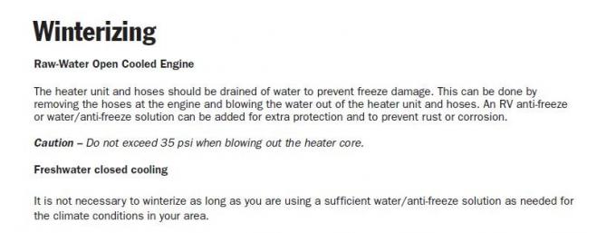

The question isn't where is the heater core? The question is, in that year if it has coolant or water flowing thur the heater core? If you already know it is water, then it really does not matter where it is, just take off the hoses when you winterize and blow air through it. Download engine operating manual info at pcm website and go from there.
It's up in the front. Basically, it's right in front of your knees when you're driving. You can easily access it by taking the seat back off in the bow. It's the cushion right in front of the captain's seat.
As far as winterizing it goes, you need to know if you have open-circuit cooling. If you do, you will have to winterize the heater loop.
Assuming you have an H5, H6, or ZR4 engine, your heater will have water running through it and will need to be drained. This is very simple. Just disconnect the red hoses from the engine and force the water out by introducing compressed air into one of the two lines. Continue until no more water comes out. In a pinch, you can even use your mouth to blow into one of the lines. It doesn't take much pressure.
If you have an XR550 or XS550, you'll have anti-freeze in the heater lines and will not need to worry about draining it. Also, if your boat happens to be a Coastal Edition, it will have anti-freeze in the heater lines no matter which engine you have.

That's not a ZR4. That's a ZR409. All ZR409 and ZR450 engines are closed-cooled. Very similar engine (ZR4 and ZR409), but the cooling system is different, and the HP rating is different too.

There's a vent behind the driver's seat, but the core should be up front. All you need to do is blow the water out of the lines. I usually just disconnect both lines and put a shop-vac over one of them. Once the water is out, you're done. You can even reconnect the lines to the fittings and you'll be good to go in the spring.
