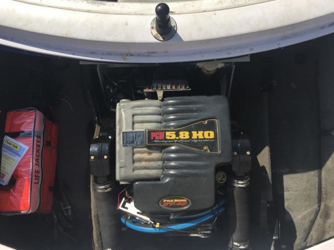

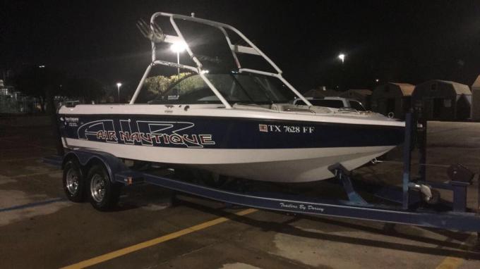

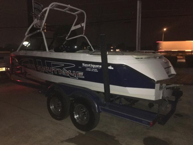

              Been super busy recently but a lot has happened! Boat is back and running with a Jasper re manufactured GT-40. It is all stock except for an upgraded transmission and a satellite Perfect Pass. Put 7 or 8 hours on it in Texas before being trailer-ed back to New Jersey. Replaced the steering and throttle cables, which yielded a huge improvement for the steering but not as much for the throttle. We will most likely be replacing the whole throttle assembly in the future. But for now the boat is winterized in NJ, getting quotes for the upholstery to get done during the winter, so by spring she should be ready to go!

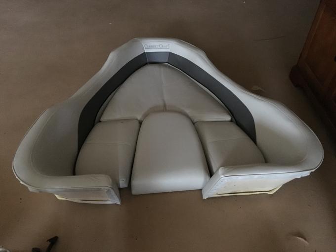

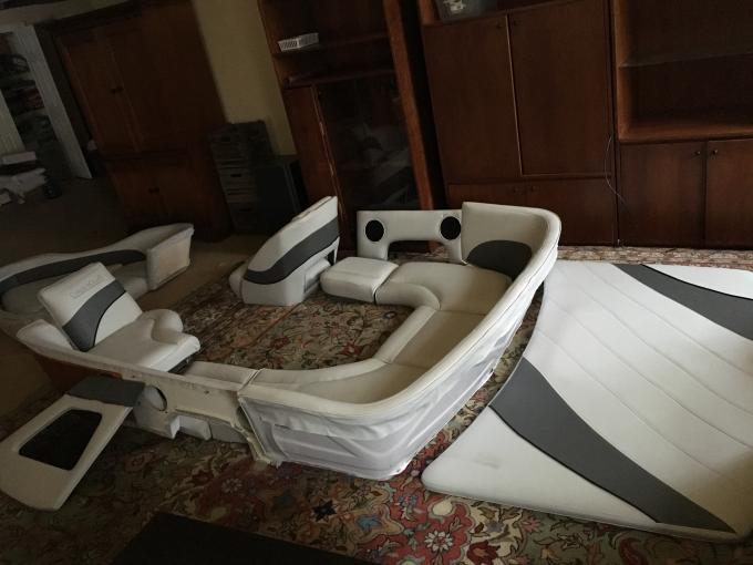

ID:	549404 Just picked up the new upholstery! There are some small wrinkles that should come out with some sun. Looking forward to getting it into the boat but there is more to be done before that happens. Plan to buff the interior and install a speaker system.

                          Looks great. Just curious why you trailer your boat all the way from Texas to NJ. Is this your second home or something? Seems a long way to trailer a boat.

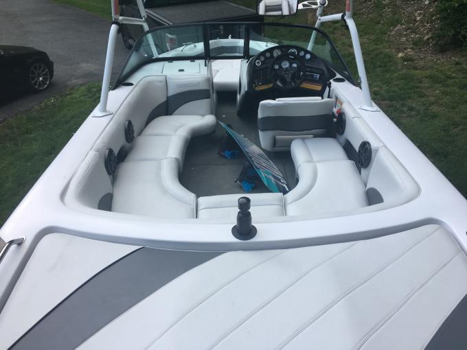

                            Have been super busy and haven't had the time to post an update, but a lot has been done! Boat is basically finished, interior, speakers, and tower speakers are all in. Just need to install the subwoofer and it will be complete. Plan to install a JL Audio infinite baffle on the left side of the walk through and seal the gaps in the fold up seat. We have put about 26 hours on it changing the oil this weekend for the 25 hour service.
                            Everything is running smoothly, engine timing seems to be off slightly which will be addressed towards the end of the season. We are having one main issue with the Stargazer GPS Perfect Pass. It will continuously turn on and off and flash the loading screen with a really annoying beep. We spoke to the engine installer and they said it is due to low voltage but we have a dual battery set up with a cranking and deep cycle battery. If anyone has any idea of where to start to check the wiring on it that would be greatly appreciated.

                                I have heard a couple different things about this but the solution seems to be the same. You need to increase your ground line and possibly run a dedicated power line to the PP.
                                Search the ccfan forums and you will see this issue often. This year was known for grounding and power issues in the dash.
