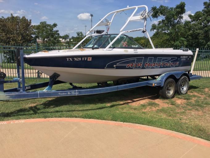

                Attached are some pictures of how she sits right now. It's a sad sight:
                Click image for larger version  Name:	IMG_6040.jpg Views:	1 Size:	81.4 KB ID:	538802Click image for larger version  Name:	IMG_6039.jpg Views:	1 Size:	90.1 KB ID:	538801Click image for larger version  Name:	IMG_6035.jpg Views:	1 Size:	61.3 KB ID:	538800

                  Sad for sure, but the satisfaction in restoring something like this is immeasurable. That interior is a hot mess. Looks like you are going to need new seat and combing pad foam as well. Christine's Marine would be a good source for that (assuming you didn't know that already). With new skins that interior will look sharp.
                  I see it has PerfectPass. Hopefully it is still functional. If not you can contact them and (as I understand it) they can repair it.
                  PerfectPass Control Systems Inc.
                  14 Trider Crescent
                  Burnside Industrial Park
                  Dartmouth, NS
                  Canada B3B 1R6
                  (902) 468-2150
                  It may be outside your budget, but replacing the carpet with SeaDeck is a nice upgrade (I would do yours in gray). A user on this forum did it and it turned out great. You might be able to contact him and get a copy of his templates. He also had a 1999 SAN. http://www.correctcraftfan.com/forum...ll-on-1999-san
                  At least you have a trailer. Don't overlook the wheel bearings and brakes. I am guessing they will need servicing as well.

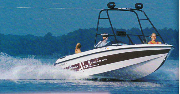

                  Interesting graphics. Yours looks to be from the DD Air Nautique. I suppose the original owner could have ordered it that way. The 1999 SAN graphics looked like this. Unfortunately they are not available any more. Too bad because they look very cool. Lucky too you have the 2nd generation of the flight control tower (FCT1). Much better looking than the original version. More functional too.
                  Click image for larger version  Name:	Capture.PNG Views:	1 Size:	405.2 KB ID:	538819
