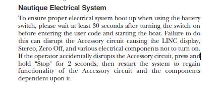

        Sorry for dumb question. But after you turn on the battery switch are you waiting before you type in code and press start. If I don't wait like the picture suggests then my won't boot. If mine does not boot, then i turn off the battery switch wait a few seconds, and then turn back on the battery switch, then wait 30 seconds...Never failed yet.
        p.s. on the actuators why don't you compare what each side sounds like and make sure ok, or switch them and see if problem moves to other side.

          Good idea, I will definitely try the waiting 30 seconds to see if that helps the booting up!

            Unfortunately the waiting 30 seconds from perko on didn't improve the LINC booting situation. In addition I could not get into the software update loader on the LINC screen through the instructions provided by the dealer so I could not try updating the software. Probably tried to get in there about 100 times and the screen was just completely non-responsive when holding the home button during start.
