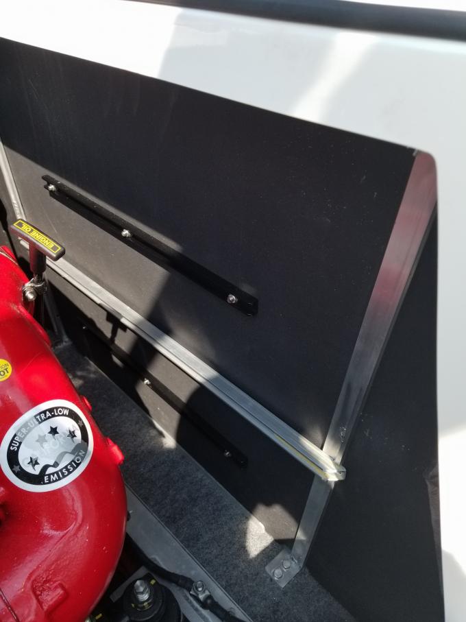

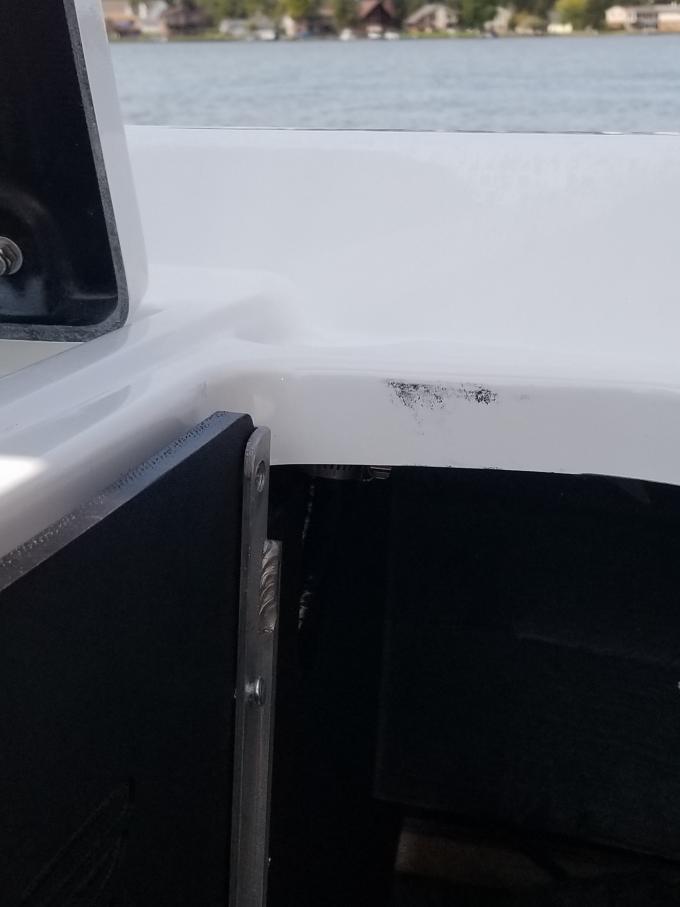

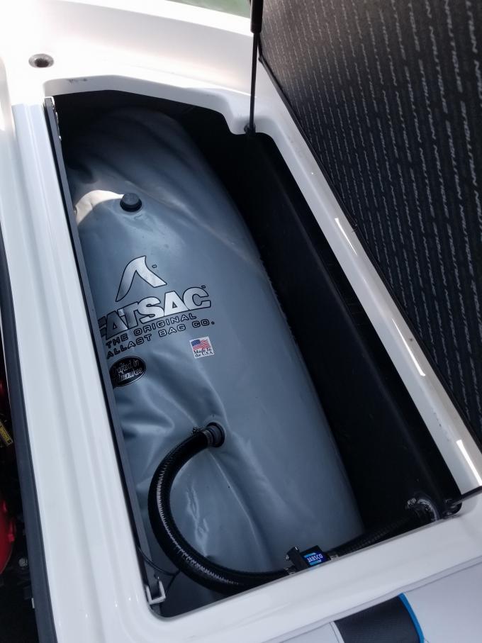

                Here is what I did when installing 750 fatsacs in my 17 210. Pictures of port side attached.
                Installed the panel savers horizontal on engine side (only installed 2).
                Installed a pin at stern end of panel to keep panel from riding up and "jumping the track" out of the c channel when sac is filling.
                I removed the storage trays.
                Have had no issues with this setup which has been about a month now. Picture of full fatsac also attached.

                    This is exactly what I did. Pin and everything
