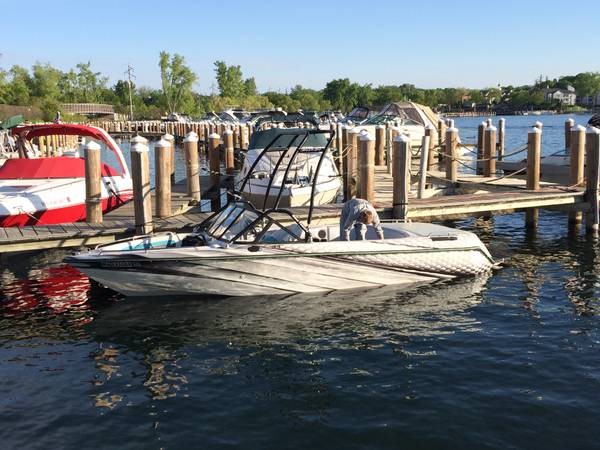

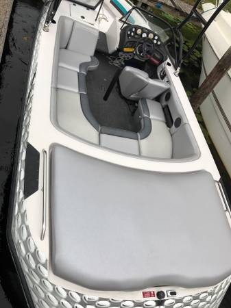

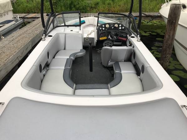

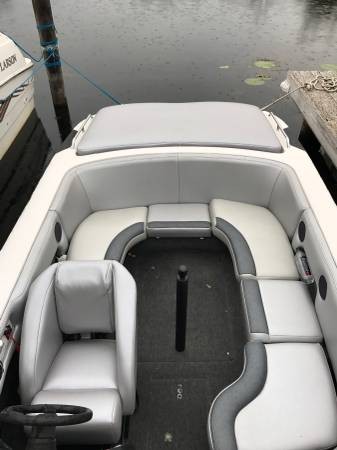

Thanks. 830 hrs. Has a full vinyl wrap that's a little scraped up (to be expected I think), full cover, new vinyl except for bow (not sure why they didn't do that), no pad in the playpen. He's asking $12000 firm. Haven't been able to line up a test ride, and it's sitting in a slip, so I don't know what the trailer condition is. Let me know what you think!
The look of the boat has been changed significantly. I don't think it looks too bad but it's not great either( would be easier to tell in person). From the bow the original colours where black and teal. Not the most popular colours scheme for a Nautique(my last boat was a teal 1995 Sport). The updated look may affect resale but I'll leave it up to you to decide if you like it or not.
800 hours is average for a boat of that age, less hours wouldn't be any better as it would mean the boat wasn't used much which can be bad for an engine.
The issue with wraps is you don't know what's under it. I'd guess he just wasn't a fan of the old school color scheme and just wanted to update it but make sure to ask him if there is any damage under there. Look at the condition of the unwrapped parts of the boat. Look for signs of damage on the gunnells, dash and underneath. Make sure the gages all work and check the condition of the engine.

That boat will produce an amazing wake and with the new suck gates and some ballast it will also produce a good surf wave. It's pretty impossible to get a boat as good as that with a tower for wakeboarding for under 12k. If you are happy with how it looks and there are no issues on the water test then considered it.
If you think you'd want to get the boat back to original, then walk away as you'd be better off getting something thats not updated.
For $12k it looks decent. Doesn't look perfect by any means but if it's mechanically sound including engine and trailer I'd probably buy it for $12k and have a ton of fun.
