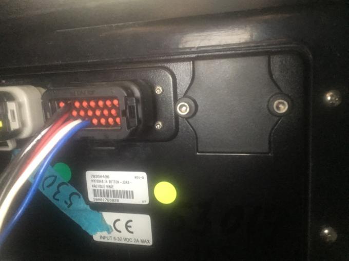

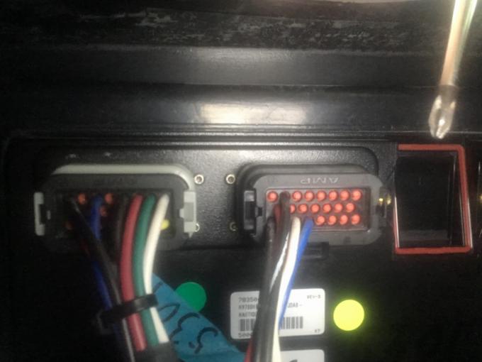

                    Click image for larger version  Name:	IMG_1987.JPG Views:	1 Size:	33.3 KB ID:	535206
                    It takes a whole ten minutes to install it. Couldn't wait any longer. Had to play hooky from work and figure it out. I first started by popping the bezel off carefully. No screws were revealed..... okay... pop the dash top and had another peek. First, the screws that hold the whole link screen unit are screwed in from behind the dash. Not the front. I found two Allen screws holding the access cover to the chip. Just an SD card. It was right where it should be in position. Strange. Why won't it work? I pressed on it and it popped up like an SD card does. I re-inserted it. Presto. My nav works again. Sure hope this doesn't become a regular issue. I will say this: I formed a new resolve to carry some small tools on the boat at all times. Some pics of the back of the link screen with the chip cover on and off.

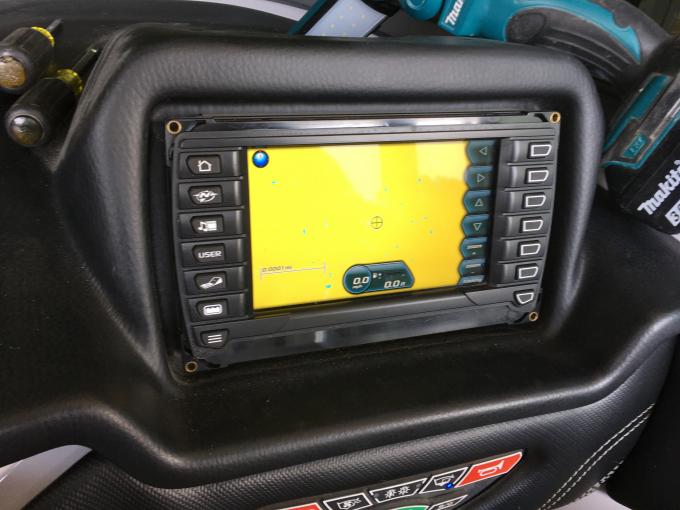

ID:	535268 Yeah must be. Here, you can see what I saw when I took the bezel off. Looks like there were provisions for screwing it to the front if they wanted to.

                          his last picture looks exactly like my '12, am I missing something?
