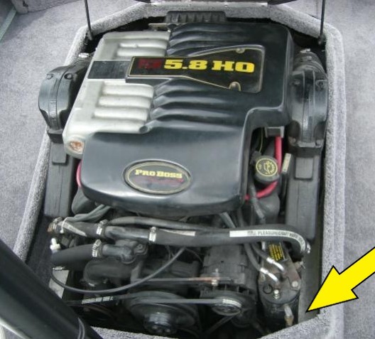

        I won't be able to get a picture until next week, however here is the same engine compartment with an arrow showing approximately where I mounted it. There is an aluminum rail that the engine mounts on. I mounted my pump on that rail in front of the FCC.
          Ok that is where my first aerator pump is located .
          Since speaking with you I'm definitely going to put the reversible pump in..
          Definitely would love to see exactly how you did yours

            I mounted mine where a0128 mentioned. It worked good since the intake is right there. I never got a lot of flow out of the pump but After more research I probably should have drilled some holes in the scoop to get more water in the pump
