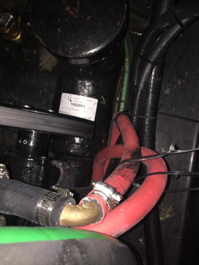

    After a few zip ties.....I've got about 30 hours on it since the zip ties, no issues at all.

        Hogwild , that is crazy! It looks like your heater hoses were the issue and not your fuel lines.
        That wasn't even the TSB!
              You are correct and I said the same thing, but I was told if the line were to contact the wheel and bust it would cause an overheating issue with the engine....the mechanics of why were explained to me but I forget. On another note, my neighbor has a 2017 G23 without the heater option. I checked his for him and the hoses weren't even close to the wheels and appeared to be already zip tied and screwed to the side of the hull, so it was a non issue for him. Logic tells me it's only on boats equipped with heaters.

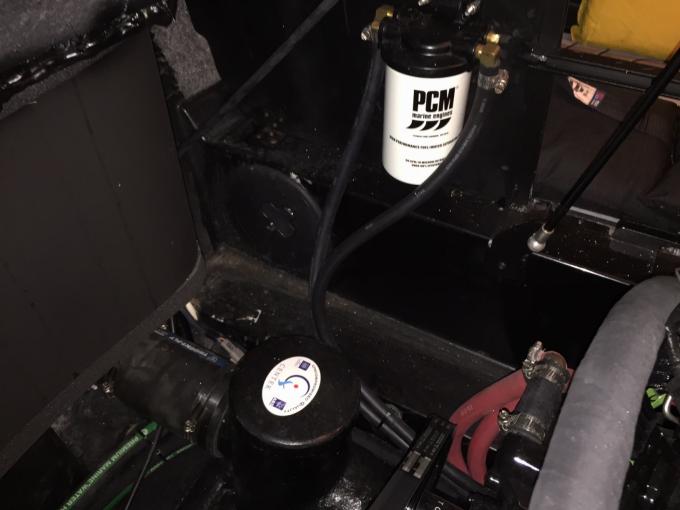

                      Pic 1:
Name:	G23 Fuel Line 01.JPG
                      I got a phone call from my salesman this afternoon; no letter yet. Not sure if mine even needed anything--you can see the zip tie attached to the side of the boat in the bottom center of the photo. And I have a heater.

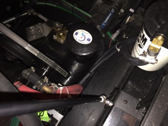

                        Pic 2:
Name:	G23 Fuel LIne 02.JPG
                        Different angle; but I added the three white zip ties just in case. Just like in the similar case above, it seemed like the red ones were more worthy of the zip ties than the fuel lines.

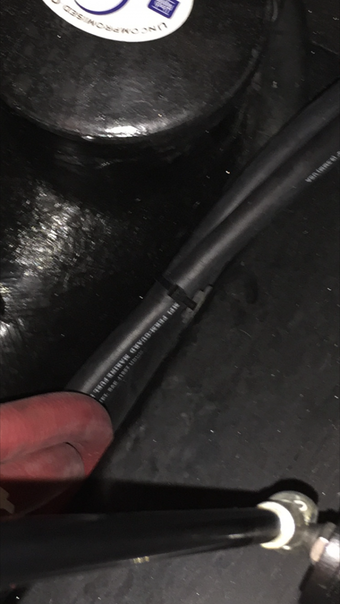

                          Pic 03:
Name:	G23 Fuel Line 03.PNG
                          Close up of the zip tie that was there. I was recently in for the 25-hour service and it's possible that they added this zip tie then.
                            Mine has a heater and both were fine. Probably depends on what day of the week the boat was made. Ha!
                            to answer your other question, if the heater hose tears or gets ripped off then you are basically running engine water out of the engine! **** right that will cause an overheating issue!
