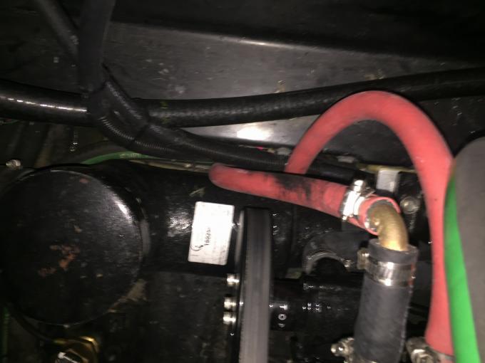

      Originally posted by gmdog2 View Post
      Glad they got you in and done..so I take it the red lines are the new ones? I hear you on the service issues..25 hrs, 7th time out...towed in by a 84 Cris Craft w/1500hrs org motor n outdrive.Little disappointed to say the least. If I didn't like the dang thing so much, I'd go back to MC
      Sent from my Galaxy S11+
      No, the red lines are the heater hoses. The black lines are the fuel lines. Looks like a couple zip ties will do the trick. I will do it myself.

                Can someone put pictures of fuel lines incorrectly routed, so we can check without going to the dealer if the dealer is far away..... Please no discussion on dealer area, you will be disappointed .

                      I looked at mine today and they are fine. I was going to take a pic before I corrected it but nothing to take a picture of. I would say if it looks different than the "fix" posted then make it look like the fix. Looks like whatever it is, a couple zip ties would do the trick.
                          Can you explain your 'fix' in more detail? And how did you get in there to access it?
                          • DocPhil
                            • Jan 2016
                            • 478
                            • Midwest
                            • 2016 G23; yamaha superjet
                            #28
                            shanesj posted a picture on the first page of the rerouted lines. That is exactly what mine look like. Open your engine hatch and storage hatches and remove the port side engine divider panel. This should give you plenty of access.
                            All you are trying to do is get the fuel lines away from the belt and pulley. The fuel lines are the black ones in the pic. The red lines are the heater hoses.
                              Thanks. That's what I thought. And then just zip tie the hose in place to something solid? So it cannot come in contact the belt/pulley.
                                Exactly right, it takes about 5 minutes to fix. I took a couple of zip ties and anchored them to the bracket where your shock absorber attaches for the port side rear compartment. Here's a before and after photo.....notice how close the red hose was before and the black that was starting to show up on the hose, like it came into contact with it a time or 2.
                                Before
