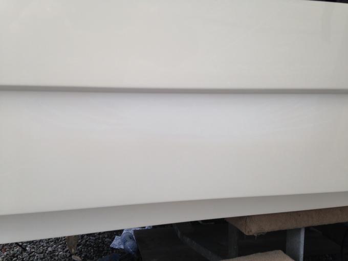

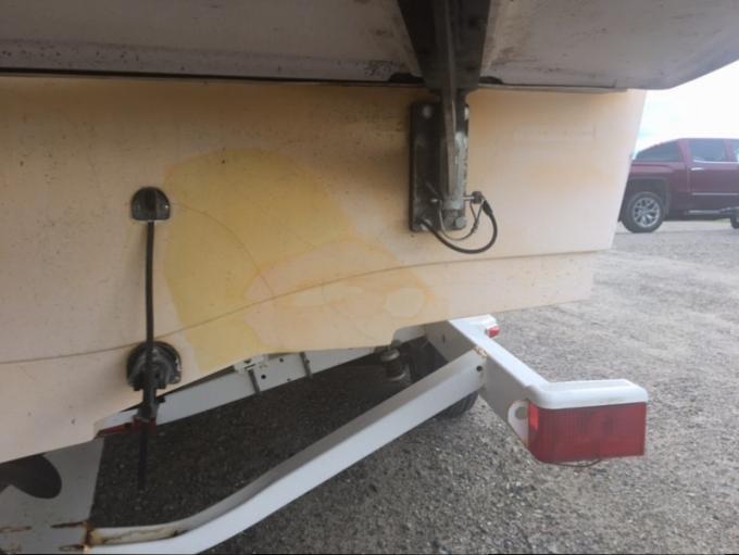

It's a second owner and they don't have any knowledge as boat came with a house purchase... things that I have read seem like the cracks could be "normal" over time but the discolouring is my bigger concern... it does appear to have been repaired but I'm looking for some advise... I'm a first time buyer and really like the 211 and the layout... any further insight would be greatly appreciated!
That's almost certainly a previous repair done poorly.Please do not PM me directly asking for advice on how to repair your boat. While I would love to help everyone, I simply do not have time to respond to all of the inquiries. Please post your questions on the forum, so that all of our members have a chance to answer.
it could be two different issues in the same place. The discolouration as others have pointed out is most likely a previous repair. I wouldn't be so quick to say its a poor repair, unsightly, yes but it may well have been carried out very well. Why don't you get a little rubbing compound and polish the area, that will remove the oxidation and give you a clearer picture.
Colour matching can be difficult, here is a pic of some gel damage that I repaired on my old MC, the colour was not perfect, but the repair was sound...

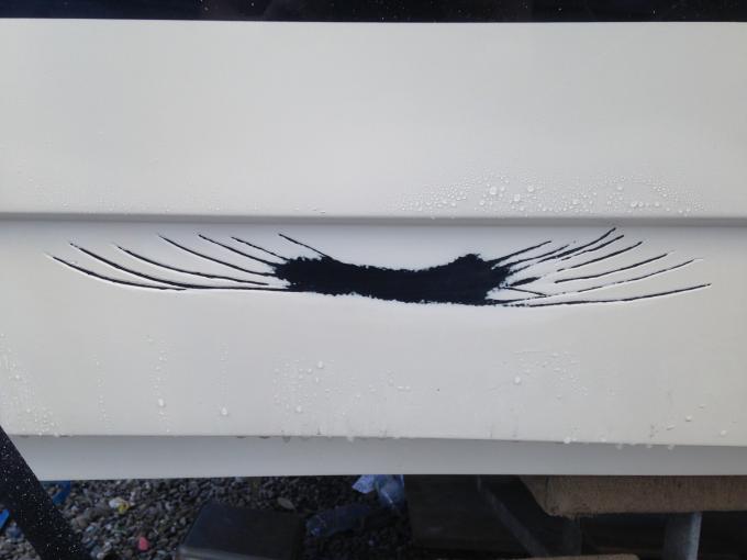

The spider crack doesn't look particularly serious but worth addressing. Is the area solid, does anything move or flex when you push against it? When you tap the area does it sound the same as when you tap the same area on the other side? If everything is fine, its certainly not a reason to walk away from the boat.Last edited by ally505; 07-16-2017, 05:18 AM.
