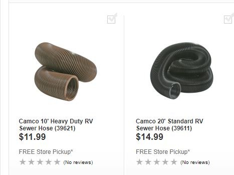

I used rv sewer line...much thicker...If not for the pull outs works great...the thinner stuff is maybe better for the pull out "hot tubes"... just kind of depends on how long you need, if not in a "hot tube" I would use the thicker stuff. If use the thicker stuff in the hot tube you can't fit as much length in the tube cause it is thicker. Below shows a heavy duty and a standard...both of which will probably be thicker then the stuff that comes with the heater.
https://www.amazon.com/Camco-39661-H...mco+sewer+hose
