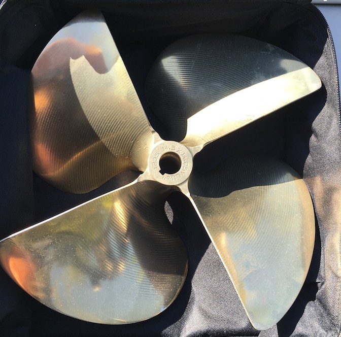

                I have a 1235 ACME prop for sale in perfect condition it was a spare prop for my 230.
                Asking $ 350 shipped
                916 202 1422 txt
                    916 202 1422 txt
Name:	1235 Prop .jpg
                    Wish I would have checked back on the post, ended up buying one. I do like it though, I honestly thought it would have more grunt than it does. But at the end of the day, it does what I wanted it to.
                      916 202 1422 txt
                      I want it. I'm local. I left you a message.
