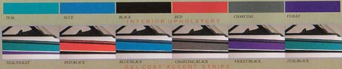

            Now for the the boat color question. I have some thoughts here.
            First, are you referring to the pinstripe or the gelcoat stripe in the side of the boat?
            Second, I am pretty sure Danny's boat is teal and black (teal main stripe, black accent strip). The teal can just look more blue than green in certain lighting. Here are the colors from the 1995 CC brochure (I don't think the colors changed 94,95,96). The teal and black matches danny's boat.
Name:	CC colours.JPG
            I assume you have the this color scheme.

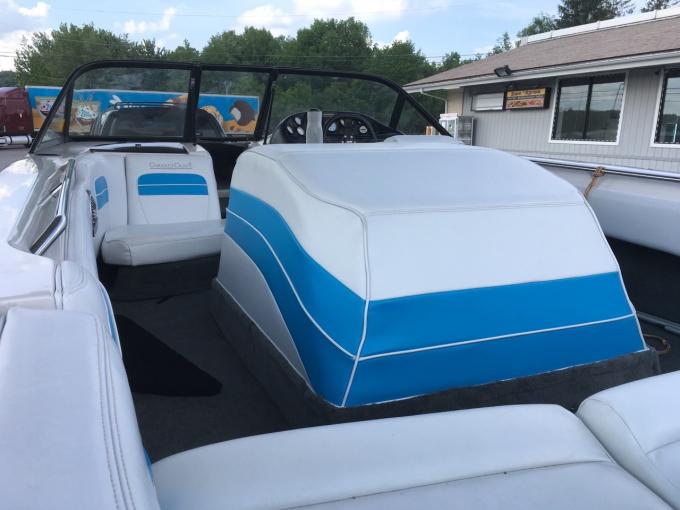

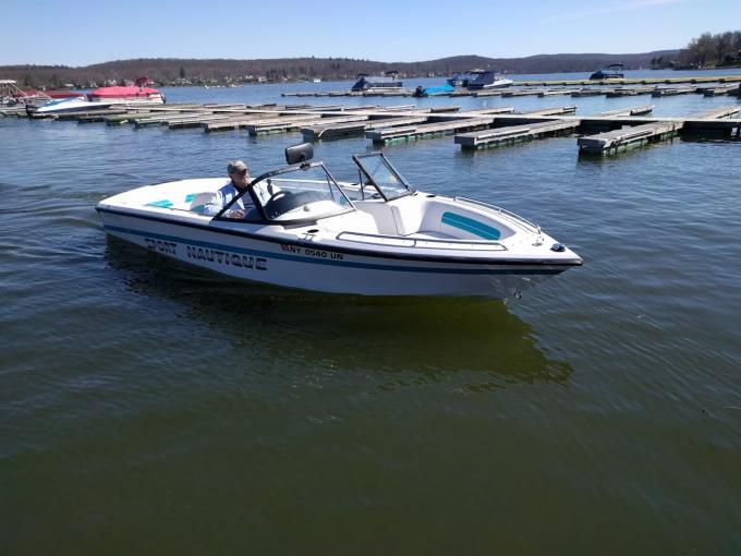

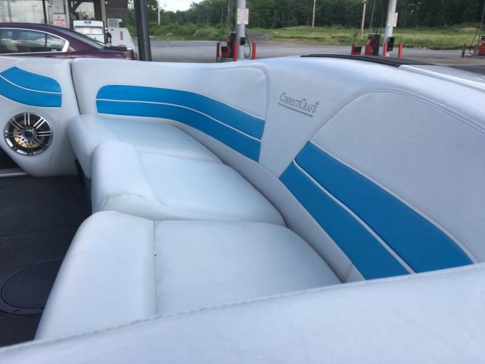

            I had a teal 1995 Sport Nautique. I updated the interior to be light blue. My boat only had the teal stripe and didn't have the white. Here is a pic.
            Here is a pic of my boat looking more blue than teal due to the lighting
Name:	Boat in Water.jpg

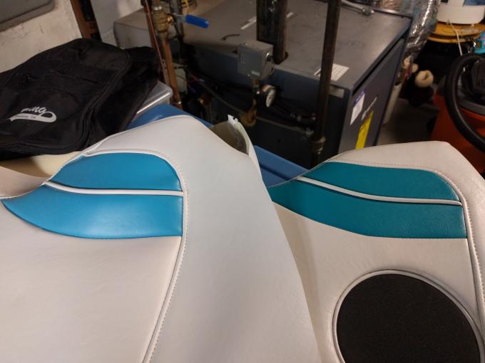

            I decided to change the interior of the boat to light blue. Here is a pic of the different colors. Old on right, new on left.
            As mention above, I am pretty sure Danny's boat in the color of the right vinyl. The main reason I decided to change the vinyl was the original teal wasn't available and the new colors, while being a closer match to the original vinyl were more green, which I didn't like at all.
            And here is the boat with most of the vinyl installed.
ID:	527382Click image for larger version
            My thoughts after getting the boat done were that the interior looked much better in the new color but the difference in the outside stripe color and interior color were obvious to me. I finished the interior the day I sold the boat, so i did't have much time to 'get used to it'. I did think that if I had kept the boat I may have covered the stripe with a piece of vinyl so the color matched.
