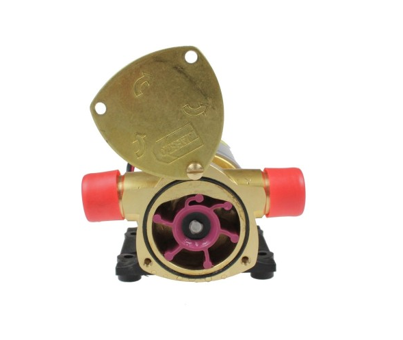

                  They are super easy to get to and to change on the G23, the three pumps right under the floor hatch. 15 minutes start to finish. Pop the brass triangle tops off (3 screws, but you only have to take 2 out and swivel), pull the old impeller out, take the old o-ring off and put a new impeller and o-ring in. The impeller is just held on by light compression in the hub, no keeper on it. Some kits come with a little lube you can put on the o-ring and impeller. You might need to use some needle-nose pliers or other tool to get the old ones out - they can get a little stuck on the shaft sometimes. Just pull and they will come out. Try not to scratch the housing.
                  We change out every 50-75 hours or every season or so. We usually have one start to misbehave sporadically by then, and have had one go completely bad in as little as 30 hours. You can tell when you have one starting to go as you will have occasions where a pump seems like it wont prime and you have to mess around to get it to fill. You can usually get all three for $100 or so, and they take 15 minutes max to replace - cheap insurance for not ruining lake time. I hang on to one or two of the best looking used ones, coat with petroleum jelly and throw in the glove box for emergency spares - but have never needed one. At some point I might try to get a season out of my spare collection.
                  The G uses the purple ballast king impeller (23095-0007-P). Others may use the green ballast puppy. Best to pop a cover off and see which one you have before you buy.
                  Click image for larger version  Name:	Screen Shot 2019-06-08 at 8.11.48 AM.png Views:	0 Size:	148.6 KB ID:	584934
