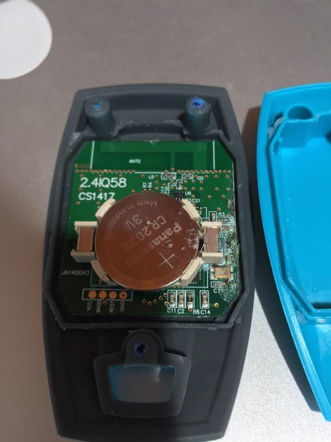

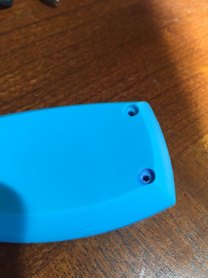

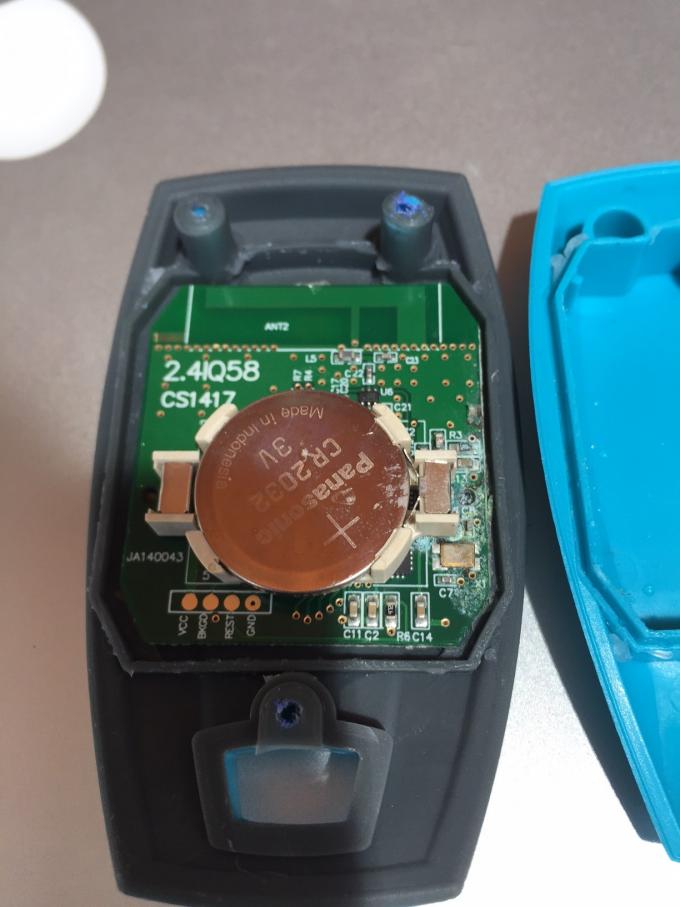

    My Surf Select remote stopped working this weekend. I figured a dead battery so I opened it up to see what type of battery it required. To my surprise it appears the seal failed, it was damp inside and the circuit board is corroded. See attached photos. One screw hole is discolored but I can't tell if it's from leaking or was a sealant applied when assembled.
    I have a warranty claim in process. Hopefully a replacement at no charge is not a tall order for Nautique.
    Anyone else have this issue?

    Funny, was just talking to the dealer about this an hour ago. Same exact thing happened to us this weekend - was working great, and then just stopped. I changed the battery, and it was clear water had gotten inside - looks a lot like yours. I am not positive this is it, as the internal red LED still lights when you push the button, but what else could it be?

            Has anyone tried drying it out, cleaning the contacts and replacing the battery? I bet it'll start working again.
                -Charles
                Yes - mine was totally dry, cleaned and new battery. The LED in the board does light when the button is pressed, but it won't pair. Tried it on a couple of boats. Something is fried.
                Nautique shipped a new one out under warranty no problem.
                In looking at it, I think there is a slight design flaw. It seems well-built, and has a good rubber seal. However, there are two screws in one side, with a lot of meat, and one screw on the other, right next to a void. I don't think the side with one screw gets cranked down hard enough to really seal up well, clamshelling against the side with two screws. It is probably enough in most cases, but not all.

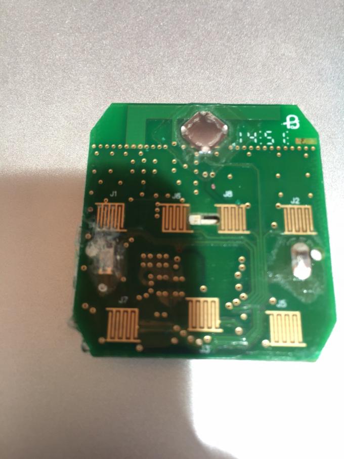

                      Now my new (replacement) remote crapped out. I opened it up and the circuit board looks fine. This one was filled with a silicone goo to keep water at bay.
