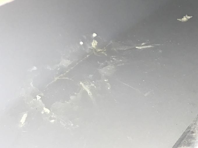

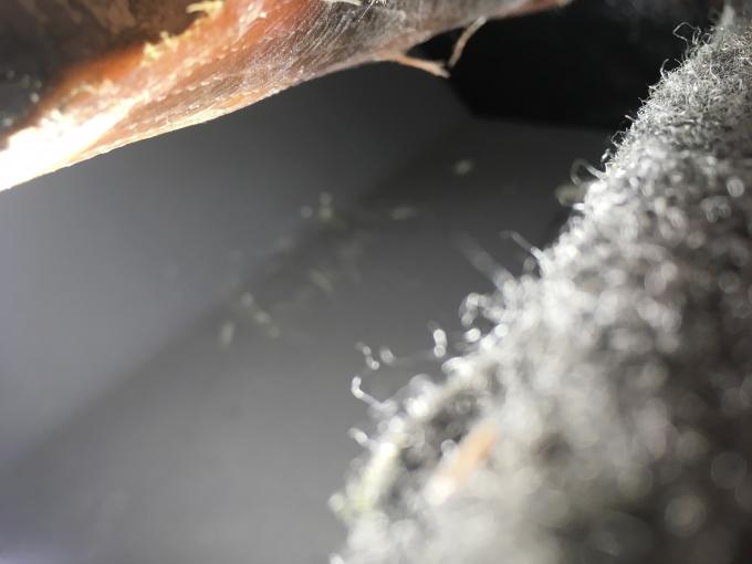

    Thanks for the tip. My wife picked some up today at Target and I applied it in a test area to see. Seemed to hold pretty well, but I was still able to peel it back if I tried. I'm giving it the overnight test to see how it reacts in the morning when I try to peel it off. It's the best temporary solution thus far. I took a few pics of the situation to the dealer and they'll be submitting it for warranty approval tomorrow.

          You can clearly see the evidence of my failed JB weld epoxy weld attempt.

            Why not just cut that tank out in pieces with a dremel/reciprocating saw and just replace with a bag? I'm surprised they still use hard tanks. I just assumed everything was bags these days.

              #21
              You'd still have to remove the fuel tank just to get to it. After that, the job is half done.

                Turns out that Felxseal tape is some pretty nasty sticky stuff. Thanks for the tip, Traves. Now, to just be able to get it into that crazy tight place without folding it over on itself and hope it holds water back... Fingers crossed... Should know this weekend if it'll work at least on a temporary basis.
