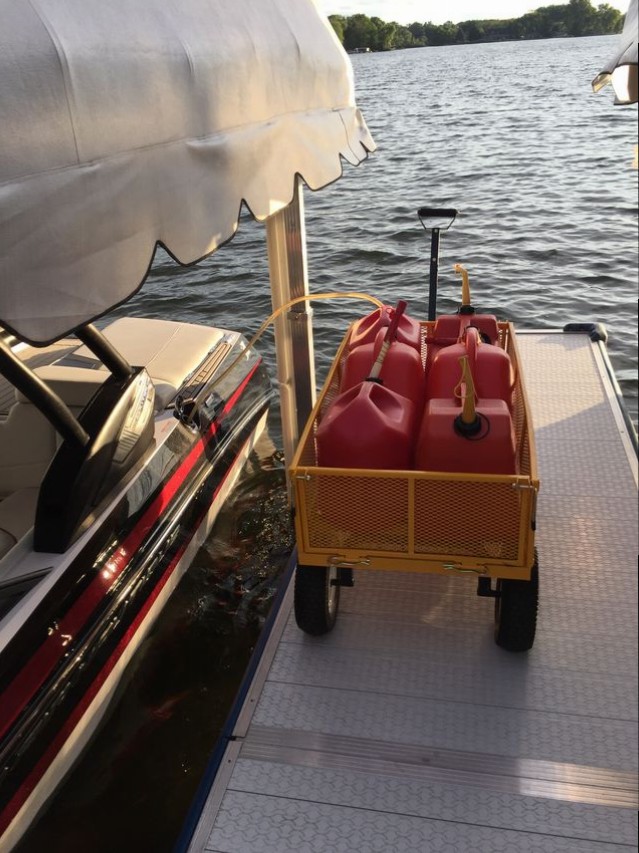

                After trying different solutions from Gas Caddy to carrying and pouring in 5 gallon cans, this was my final solution. I can fill all the cans at the gas station and roll all the way down dock. The syphon tube moves the gas directly to the boat. Maybe not the fastest but gives me a few extra minutes to clean the boat a bit more. Also nice that my kids can easily do this themselves.
Name:	Gas Wagon.jpg

                  jharris the cart is a great idea! Man I wish the path down to my boat didn't involve so many steps!

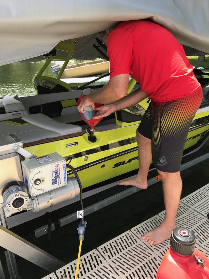

                    Easy, inexpensive and very fast.
                    First you insert the funnel. It does not move around at all because it's a snug fit.
                    Click image for larger version  Name:	IMG_2121.JPG Views:	1 Size:	46.5 KB ID:	526353
                    Then add stabil (if the gas goes in the boat the same weekend, I do it
                    this way. If the gas will be stored for any time at all, I put the stabil in the gas cans)
                    Click image for larger version  Name:	IMG_2119.JPG Views:	1 Size:	97.9 KB ID:	526350

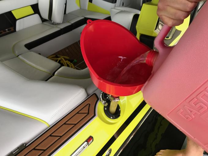

                    Then pour in your gas
                    Click image for larger version  Name:	IMG_2113.JPG Views:	1 Size:	42.6 KB ID:	526352
                    With the JP Racing gas cans, 6 gallons takes under 35 seconds.
                    With a regular gas can it's 5-10 seconds longer.
                    I can put in 4 gas cans (24 gallons), not spill a drop and be back on the water in less than 5 minutes.

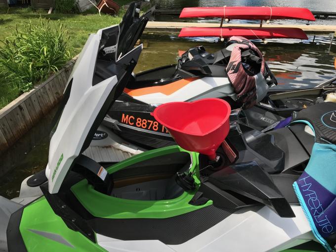

                    Exact same solution for the jetskis.
                    Click image for larger version  Name:	IMG_2109.JPG Views:	1 Size:	66.1 KB ID:	526348
