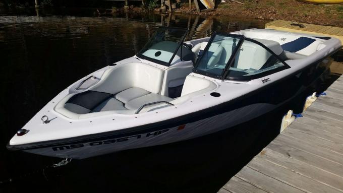

    Hey guys, been a member here for a couple months now and my boat search has finally come to an end! Picked up a 2000 Sport Nautique with the GT40 engine in North Carolina on Friday. Has less than 300 hours on it, and the Teleflex gauges actually work, although they are a little sporadic. Drove down Friday from Massachusetts and made it Saturday night. Super pumped to get this thing registered and in the water, but just have a couple questions for those with models similar to mine.
    1. Steering is locked up, you can force it to turn but it is very stiff and jerky. I'm assuming it's just the steering cable. How hard is this to replace?
    2. What type of engine oil and filter? After searching it looks like most people use 40w Valvoline VR1, what type of filter are you guys running?
    3. The boat wasn't used much last year (only 8 hours), would you guys recommend changing the transmission fluid? If so, what gear oil should I use?
    4. When trailering it home, the surge brake system seems to jerk around a lot. It really slammed back and forth when braking and accelerating, and felt like it wasn't helping with the braking. Is this normal? I've never had a trailer with a brake system before.
    5. How does the rear bench seat attach? I found the rubber handles but how do they attach to the mounting points? Also, how does the rear seat backrest mount? The sides are attached but the middle part can pop up and it looks like there's a metal prong that should attach somewhere.
    6. My fake-a-lake I bought doesn't cover the water inlet completely, is that normal?
    Glad to be here and looking forward to being part of a great community!

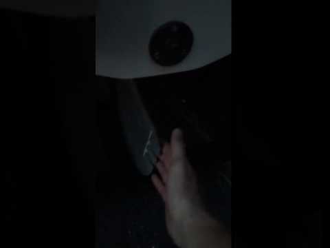

                      Alright guys, unhooked the rudder and steering rack from the cable. Turns out the cable is the problem, but I do have a question about the rudder. It moves easily but kind of jerks when I move it by hand or from the inside (see video). Think it could need the bearings replaced or greased?
                      2000 Sport Nautique - GT40, Origin Wake Tower, 2700lb Ballast System
                      • Blamey
                        • Sep 2015
                        • 595
                        • New York
                        My guess is that's normal and just making the sound because you are moving from the rudder rather than cable but I can't say so for sure. Hopefully someone with more experience can confirm.
