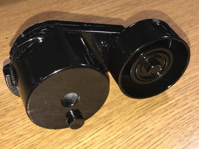

The actual pulley should not be painted, or at least not on the surface that touches the belt. Looks like they painted the whole assembly.
I would acetone or use something to remove the paint on the surface that touches the belt before installing.

Yea my dealer just called me about the recall, they have another 2017 G23 belt tensioner broke over the weekend. So they gonna replace mine tomorrow ASAP.2017 Super Air Nautique G23 Coastal Edition
