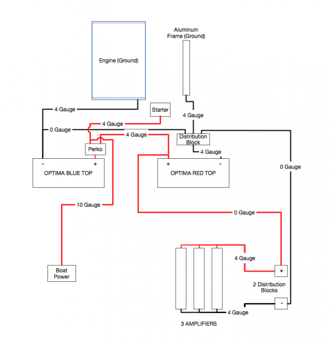

Trying to figure out why the heck I can't get my system to maintain high enough voltage to shut the voltage gauge beep up when it's in accessory (perko is set to "All"). I've attached an image with my current configuration. The batteries are less than 2 years old. Just fully charged them within the past week but I'm still having the issue.
Took my volt meter to both batteries (with perko off to seclude them). Both were reading 12.48 volts. But, as soon as I turn it onto accessory and give just a tiny bit of volume to my stereo, or turn on the ballast pumps, or turn on the lights, etc (could be any of them), it starts beeping at me and can't maintain voltage.
I'm stumped. I feel like between these two batteries, it shouldn't be an issue when they're both fully charged and the Perko is set to pull from both batteries. Any ideas??
