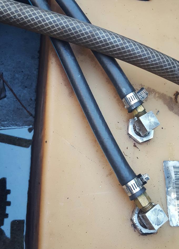

            I don't see an in line filter. I have two hoses coming off the tank. One to the fcc and one to the low pressure fuel pump. Straight hoses you both...
              There probably isn't an in-line filter on a 1997. There certainly wasn't on my 99 Air Nautique. The only filter was the one inside the FCC.
