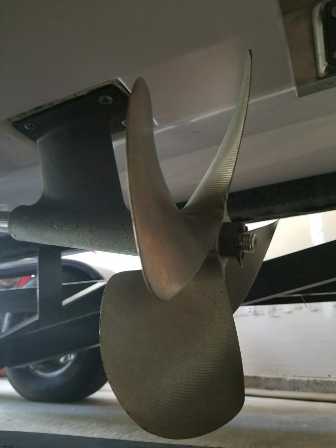

      Yeah I guess it is a lot of weight but I assume people are actually running a lot more since I have the crappy stock tanks as well. To be honest I don't know what prop it is, looks like I might have to loosen the nut to find out but pics are attached. nukemustang

        Empty boat should be capable of 45ish with stock 4 blade Acme 380, I know, I have it. Higher torque props like Acme 1578 should be able to ride with that weight at ease. Guesing from pics, yours is Acme 380 or 644. But even 644 should be able to handle that weight. Your prop should have a stamped numbers from other side of which model.

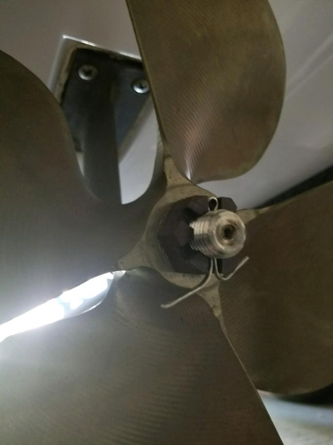

                            Edit: Numbers for the prop are under the prop nut. I can't make them out in the pic you posted.

                              That is not the stock prop, looks to be an Acme. 6500' is your biggest problem and nothing is fixing that. I used to have an 01 SAN that I would take to a lake at 4500' with an ACME 1236 which was the most aggressive prop they made at the time and I would have to take out a bunch of weight to get it to plane. Granted, I was running 3000lbs of ballast, but the elevation made a huge difference. I probably had to take out at least 1000lbs to get on plane.
                              First thing, loosen the prop nut so you can see what prop you have and let us know. At 6500' you want the most aggressive low end prop you can get. Also try putting the 540lb sack in the bow instead of ski locker to help it plane.
