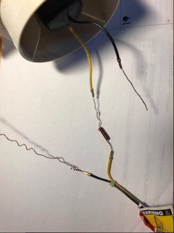

    My blower stopped working so I removed it by disconnecting the wiring at the connector. I noticed the blower side of the wiring and the blower itself is connected via a 1/2" coil of wire for both positive and negative wires. Does anyone know if they are needed? what they do (resistor?)? where to get them? Thx!
    Can you post a photo? I'm not sure I understand what you're describing.

      I just added the picture. There was black shrink wrap on the whole connection. Hindsight, I would have just cut the wires from the blower!

        Looks like there could be a resistor on the positive lead. Hard to tell from the photo.

          It's wire wrapped around a hard plastic (or possibly metal) rod about 1/2" long.

            Can't tell from the photo but from your description, it's a capacitor or sometimes called a "choke" to reduce high frequency noise from the motor.
