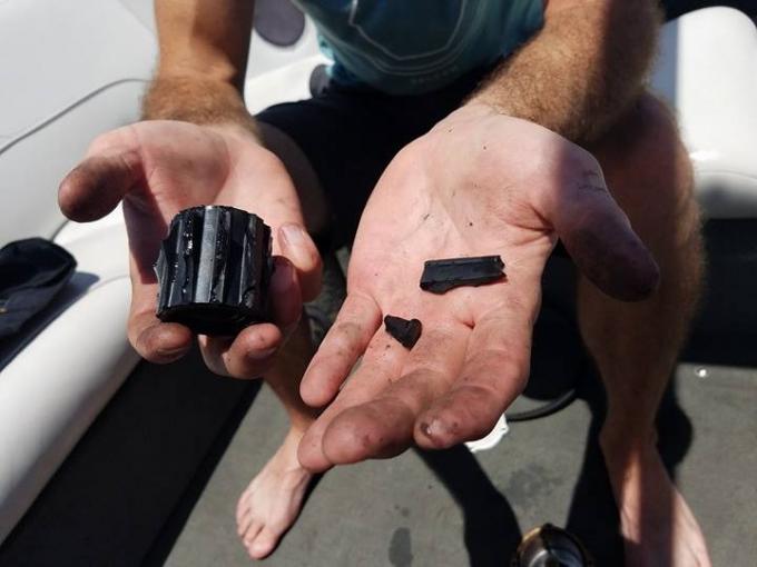

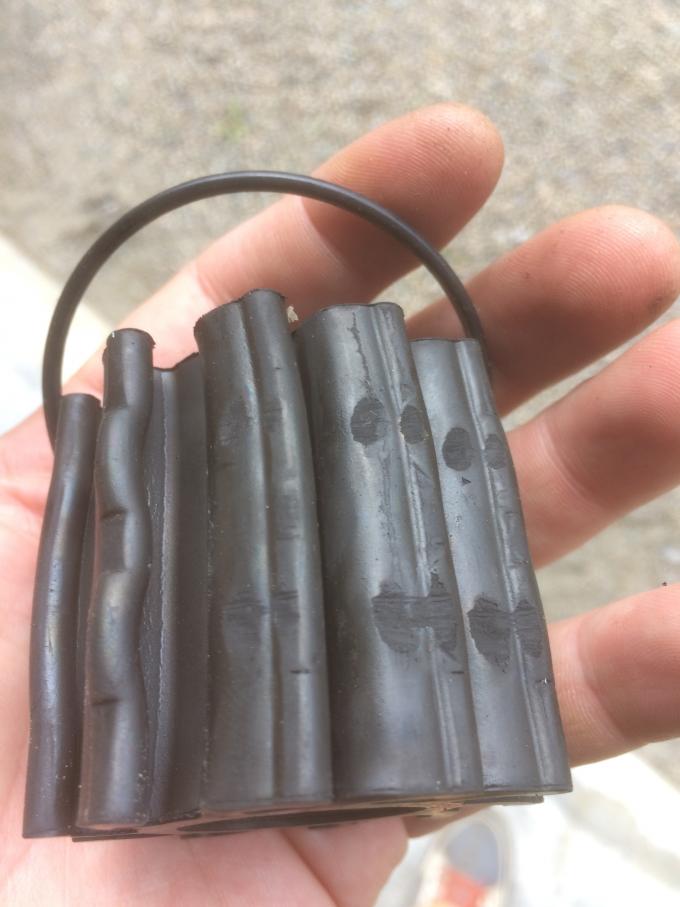

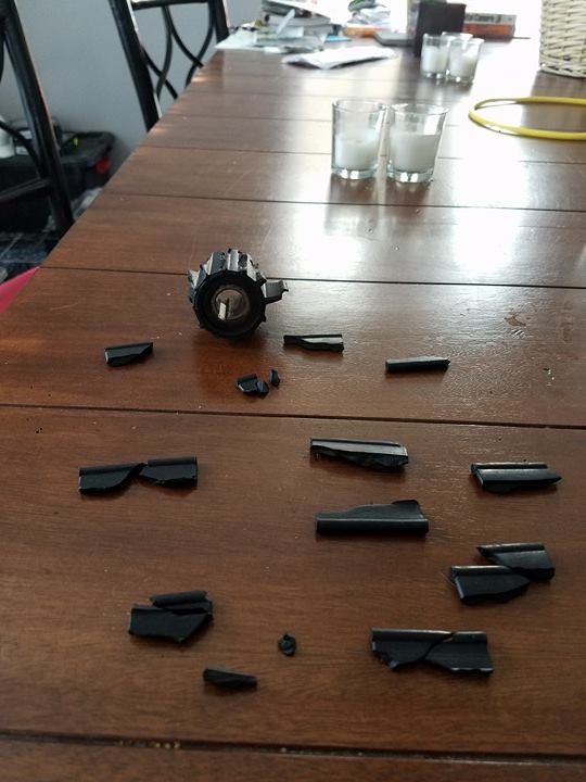

So while out for a lunch cruise the other day, our temps spiked at idle speed, 196 was highest observed temp. Cut the motor and threw the anchor immediately. I pulled the raw water pump to effect a repair on water, since I had a spare and tools in the boat. Impeller was completely shredded. I pulled the discharge hose from the pump to the v-drive inlet and flushed out some more impeller pieces. We collected what we thought to be roughly 80% of the impeller chunks and I also disconnected the inlet to the thermostat housing then fired the engine up for about 30 second to flush out anything to that point.

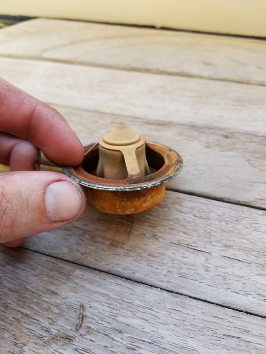

1-Established what I think to be good/normal flow all the way to the riser inlets through the cooling system, at idle RPM. Replaced thermostat somewhere in there with a 140 since that's all they had at west marine. Stock is 160, but we run in bathwater down here in Houston anyway. Should be fine right?

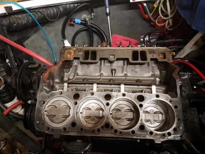

3-Removed strainer assembly to place inlet hose in bucket and check for bubbles. Attempted to start motor for this test and it locked up.

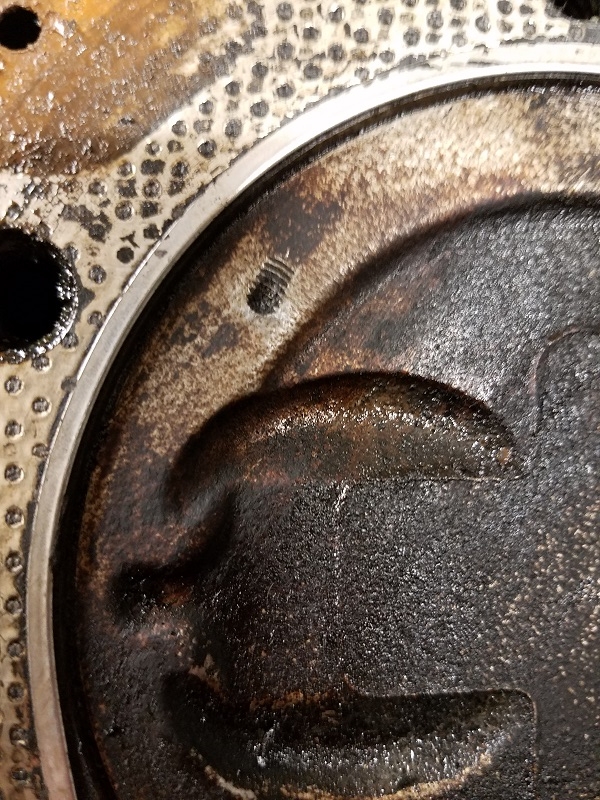

4-Removed all plugs, Cylinder 5 full of water.
5-Purge water, compression check.

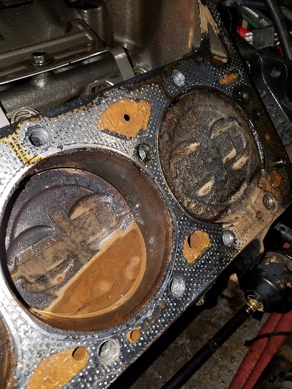

7-Plumbed strainer back up normally and hooked up hose to run motor. Engine locked on startup again. Pulled plugs, more water out of Cylinder 5.

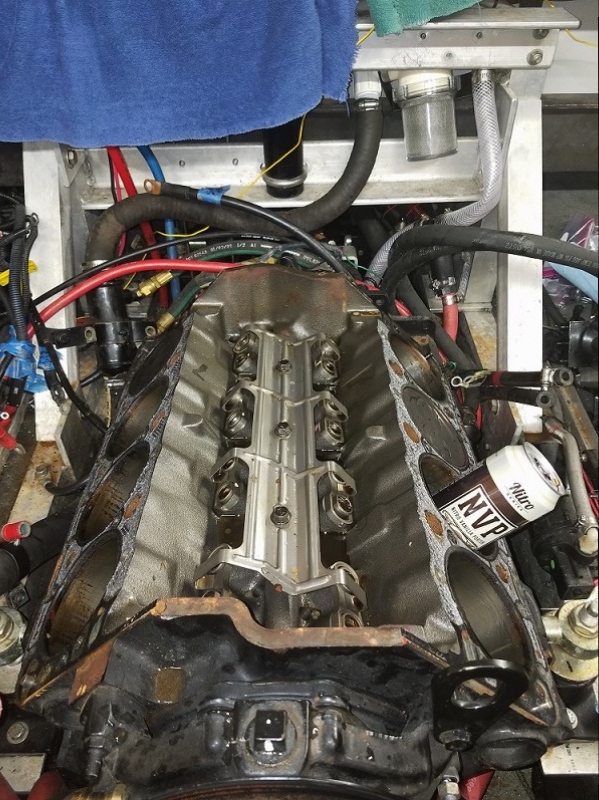

One theory is that I popped an intake gasket with water hose pressure...this seems thin to me. Possible?
Another theory is that we blew a head gasket resulting in identical compression numbers on 3,5,7 with 5 being the flooded one.

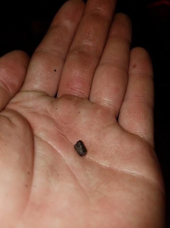

A slightly more grim theory that I cooked up is that perhaps some of that impeller made it's way into the block and is clogging something internal, thus resulting in my still climbing temps at idle. Further, with observed ET climbing to 180 prior to me shutting it down in the driveway I have to wonder, if a journal is clogged in a water jacket somewhere, is one section/cylinder of the block getting super heated, while the rest remains relatively cool?
Leak down test is next on the list which should tell us if it's the head gasket or just the intake gasket. I suppose at that point I can return to troubleshooting the climbing temps at idle issue.
