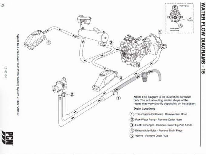

This really dumb I know. Can someone confirm the routing of the water hoses going to the raw water pump please? The hose towards the inside closest to the crankshaft is supposed to be the hose picking up sea water correct? Had this winterized and am now putting back together and it doesn't look right. The manual pics look different than my boat. 2011 nautique 230 partial closed cooling sys.
Well yea. The diagram in the PCM manual is somewhat generic. Nevertheless, the individual components and flow is consistent. You should be able to study the diagram and translate what you're seeing on the engine.Originally posted by Hoppy View PostYeah I got that but that's not what it looks like in person. The fittings are side by side not to in line
