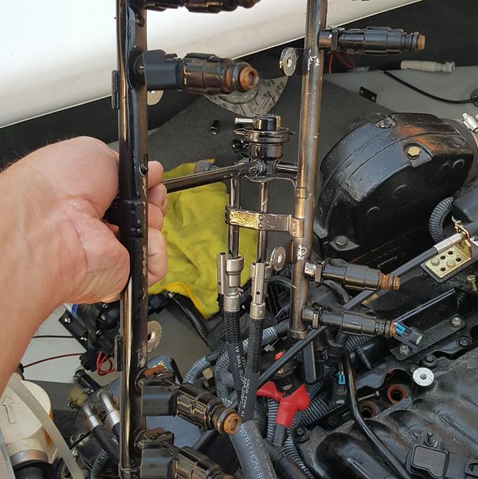

              I put all the injectors and fuel pressure regulator back in the rail but not into the manifold. Click image for larger version
ID:	518195 Nothing is leaking. Actuated each injector again with the 9 volt battery. Everything seems to be working. Maybe an injector was stuck open but worked itself out? Going to put it all back together, run it in the driveway, and see what happens. It was the first time out of the season after sitting since November.

                        If an injector was stuck it wouldn't click right? While it was running I stuck a screwdriver to each injector and put it to my ear and I could definitely hear each One clicking. I could pull all the spark plugs again after running in the driveway since they were new I guess I'd have a better idea of what they were doing. I was thinking after I ran a little bit I would change the oil again to to see what it looked like.

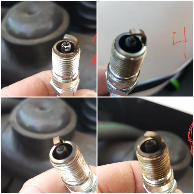

                              too rich...I haven't hooked up a scanner to it...Got the fuel at a marina last time out in March. started have problems right after that. This is what the plugs look like after i let it run for while when its running like crap...when its running fine, plugs look normal when i pull them...BTW those are new plugs

                                #30
                                Are those platinum plugs? I had thought those were a no no for old-school distributor type ignitions.
