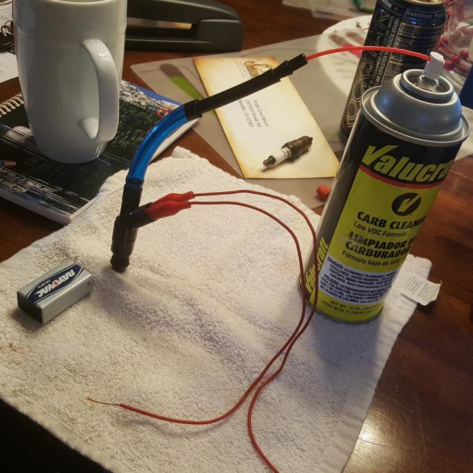

well the port side came out pretty easy. More crap in the way of the starboard side. So bench testing is something I need to have done? Or is there a way I can do some kind of test at home? They're like $150 each, so I don't want to just change them if not needed.Originally posted by DW SD View Postyep. stuck fuel injector. pull them all and bench test. or replace them all.

You can bench test if you can rig up a way to pressurize with fluid spraying in to a glass jar or similar. a 9V battery will trigger if you can find a way to energize with a suitable harness plug.

Yeah I saw some of those you tube videos with spray cleaner and a battery. A friend of mine is going to get me the number of a place he knows. Those were ford injectors. Everything I've seen with my engine were at least $150. But that was marine parts. If i can find the automotive equivalent, maybe i can find cheaper.Originally posted by DW SD View PostYou can bench test if you can rig up a way to pressurize with fluid spraying in to a glass jar or similar. a 9V battery will trigger if you can find a way to energize with a suitable harness plug.

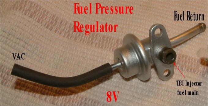

HMMM. 1. Is the pressure regulator vacuum indexed? If so, that's a possibility. I think the diaphragm can break and then dump fuel through the vacuum system. not sure about on this engine, but is a common problem on other engines.
