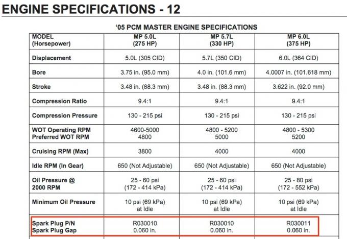

Hi, Can I check the correct plug gap for the ZR6 390. I believe should be 0.060". THe new plugs received (PCM RP030011) come in at 0.034" so a long way out. The plugs that came out the engine are 0.040".
