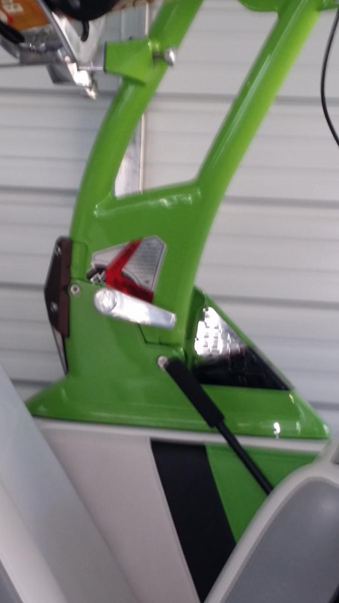

                So parts came back from paint and I sent them back to be redone. See the pitting and orange peel. I think cathodic protection is needed also to keep the aluminum base and steel tower from fighting eachother.
                hope to get parts back this week. Click image for larger version  Name:	20170422_083248.jpg Views:	1 Size:	20.8 KB ID:	518407
                        Unfortunately all you can do for dissimilar metals in atmospheric exposure is provide good barrier protection (paint) if you can dielectricly isolate the dissimilar metals that would help but Cathodic Protection (CP) would only help if it was in immersion or buried in damp soil (neither are good options for boats).
                          Hoping paint makes a barrier for now. Not many options when tower pivots on steel bolt.

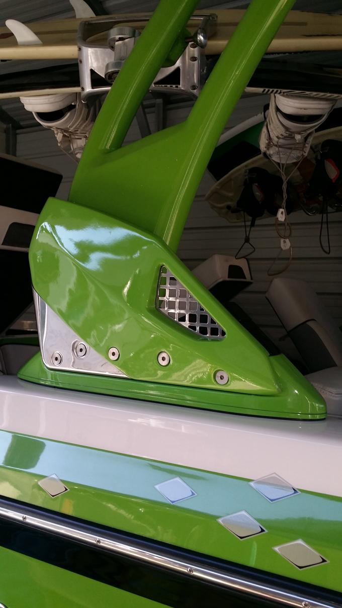

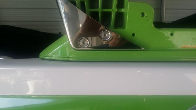

                          got all parts back and re assembled. Took her out yesterday with the kids baseball team. Great to back on the water.
ID:	519154Click image for larger version

                            Looks good, I'm tempted to do the same, but worried about snapping some of those bolts, seems straightforward forward until even just one breaks. All of yours come out clean?
                            • Outdoorjp
                              • Jul 2016
                              • 178
                              • Carlsbad
                              • 2011 SAN team 210
                              They all cam out ok, I did work a couple in and out to be safe from breaking any bolts off.
                              I'd say it's worth it, the longer you wait the worse it will be..
