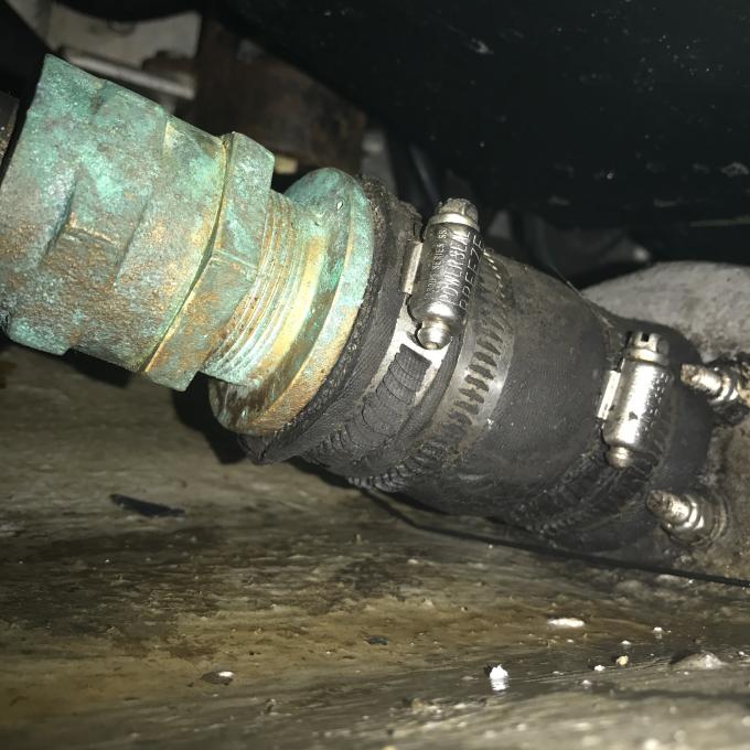

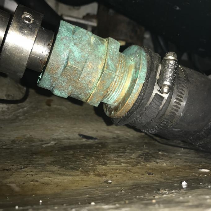

                  I just adjusted mine on my 2001 SAN just two months ago. The location sucks. Remove the top cushion of the rear seat. There are three plastic handled nuts retaining the seat. Access them from the engine locker and storage lockers. Spin them off. Then remove the seat back. Also remove the lower rear seat base. In my case, it wasn't even bolted in.
                  Get your cell phone down there and take a picture under the v-drive gearbox. This will help you orient yourself. Take a look at how many threads are exposed on the gland nut. If quite a few, likely there is remaining packing to re-tighten. If it is cranked down tight, you'll probably need to re-pack.
                  My boat used to take on several gallons / hour. After, it dripped maybe one drip every 5 to 10 seconds. The gland nut didn't get hot at speed, following, so I know it was adjusted right by those two metrics.
                  Buy the 2 7/8" gland nut wrenches - ebay has them for $30 each. They are short and aluminum and much easier to get down in to the bilge. I bought the $10 sink nut wrenches from Amazon and those thing are so freakin clunky. They are basically worthless.
                  Once the jam nut is loose, as suggested above, tighten the gland nut to the point of almost no leak. From there, put one stubby wrench on the gland nut to keep it from changing positions and tighten the jam nut. Then recheck. Not much adjustment of the nut was required to solve my issue. On a clock, I might have gone one position (1/12th of a turn).
                  The 2003 should be left-hand threaded. So tighter is counter-clockwise if you are staring down the shaft towards the propeller.
                  Also, note the safety wire. I was able to leave my safety wire attached, but just barely.
                  I attached a few pictures from my initial exploration. Kind of sucks working blindly, but once you can visualize, you can do it.

                    Doug, that is very helpful I really appreciate it. 2 questions. How do you remove or loosen the safety wire? I was not able to find the wrenches you were talking about on eBay do you have a link? I found a few that hook up too a 3/4 extension kind of like a crow foot but was not sure that is what I want.

                      Sorry. I wrote 2 7/8" but correct is 1 7/8". I bought only one and should have bought two.
                      I keep the wrench in the boat to tighten / remove my drain plug. It is getting extra duty.
                      http://www.ebay.com/itm/1-7-8-Shaft-...BXnnjS&vxp=mtr

                        I didn't need to remove the safety wire. The 1/12th turn or so I did to adjust fit the safety wire without needing to remove.
                        I did have some .030" stainless MIG wire on hand to replace it.... so I guess it was just Murphy's law. If I didn't have the stainless wire available, the old one wouldn't have worked, for sure!
                        I adjusted several of these on old Direct Drives and they were MUCH easier as they were all in plain sight... through a porthole in the floor. The v-drive came as quite a surprise when the gland nut was so buried.
                        Doug

                            Thanks I was able to get the wire off was really easy I just had not pulled out the back seat to see what I was dealing with. Will order the wrenches today and report back after they come in. I appreciate the help.
